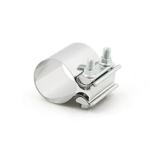

    Do nothing. Can't really spray any rust preventative like Cosmoline or Fluid Film on it because it's right next to the cat and gets really hot. The exhaust pipes are stainless steel, but that corrosion resistance goes away near welds.
    9 years from now when the flanges rot to the point of leaking, cut away the flanges completely and throw an exhaust clamp like this on there:
