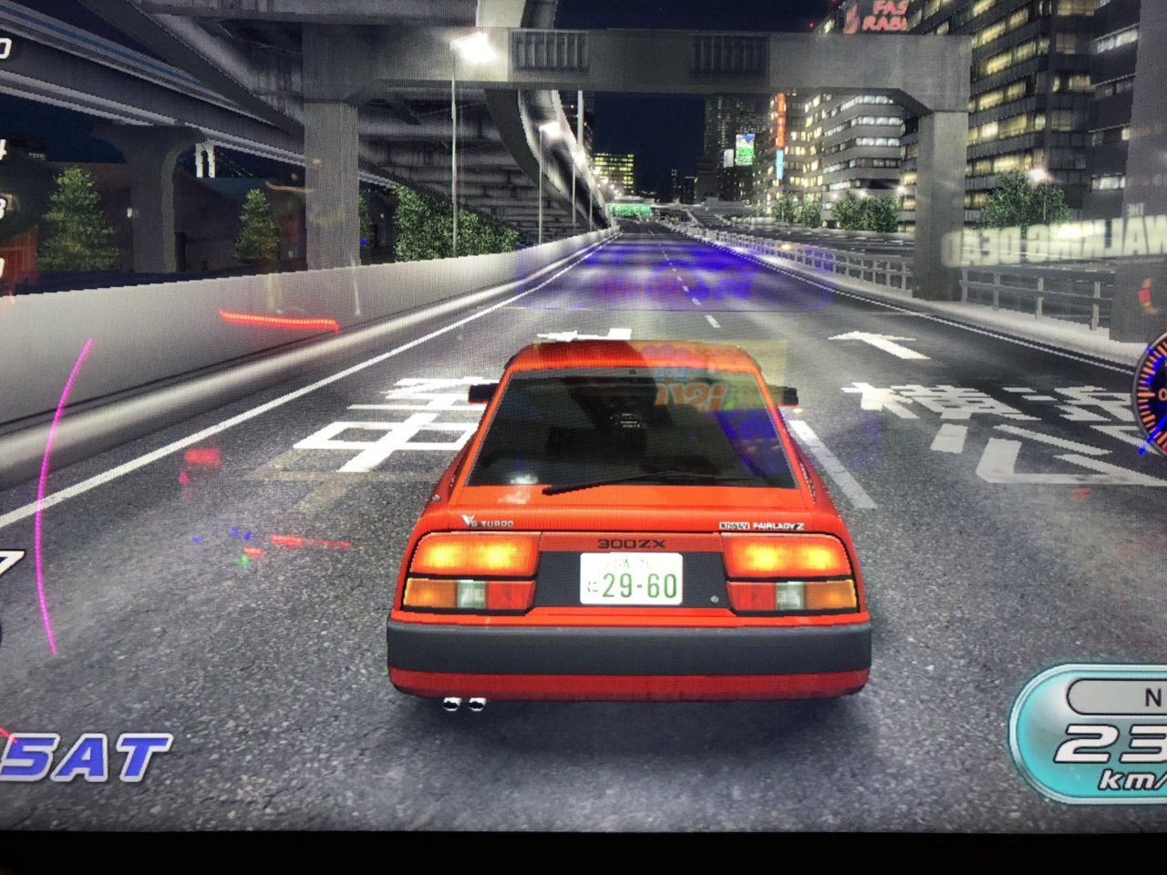

    Something surreal about playing an arcade game, and coming home to the actual car in your driveway.

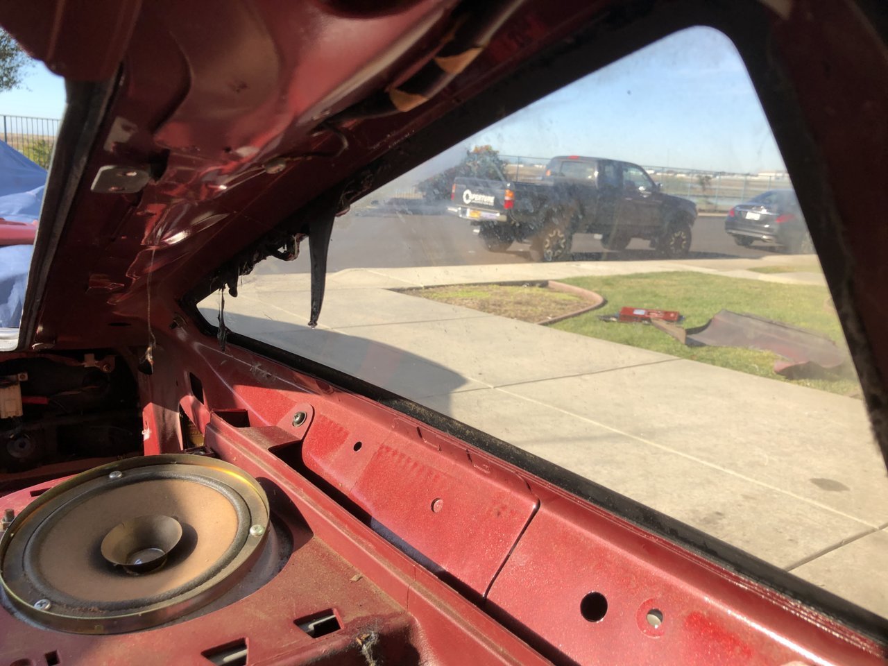

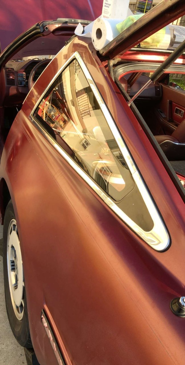

    So a common issue with these cars are water leaks. Water leaks from the T-Tops, water leaks from the mirrors, water leaks from the tail lights, water leaks from the hatch, water leaks from the rear quarter windows. A colander in a rain storm has more protection against water intrusion than this car.
    I worked on re-sealing both rear quarter windows. I noticed what I believed to be dog poop on top of the speaker grilles when I bought it, but it turned out to me melted Butyl sealant dripping from the windows. After 30 years, they’ve disintegrated into nothing. See below.
    First, I removed three fasteners that holds the window in. The plastic clip that holds the triangle trim, and two 10mm nuts. You can’t realistically remove that plastic clip without breaking it. BUT the last owner was nice enough to include a bag of brand new OEM Nissan trim clips for me.
    Then I used a heat gun and slowly heated up the butyl around the window until it was soft enough to push out.
    Now comes the fun part. Cleaning all that nasty Japanese Butyl off. Use a LOT of WD40, that stuff is magic and will melt Butyl. You’ll also need to do a lot of scraping.
    Next, I bought 3M Windoweld Butyl Ribbon sealant. This is usually used for windshields. I formed a continuous band, and kneaded the ends together at the bottom.
    Next you carefully replace the window, tighten the two 10mm nuts, and press the window evenly to seat it properly.
    And you’re done. Rinse and repeat for the other side. Next I will be doing the tail lights, which also leak badly and are sealed in the same way.
