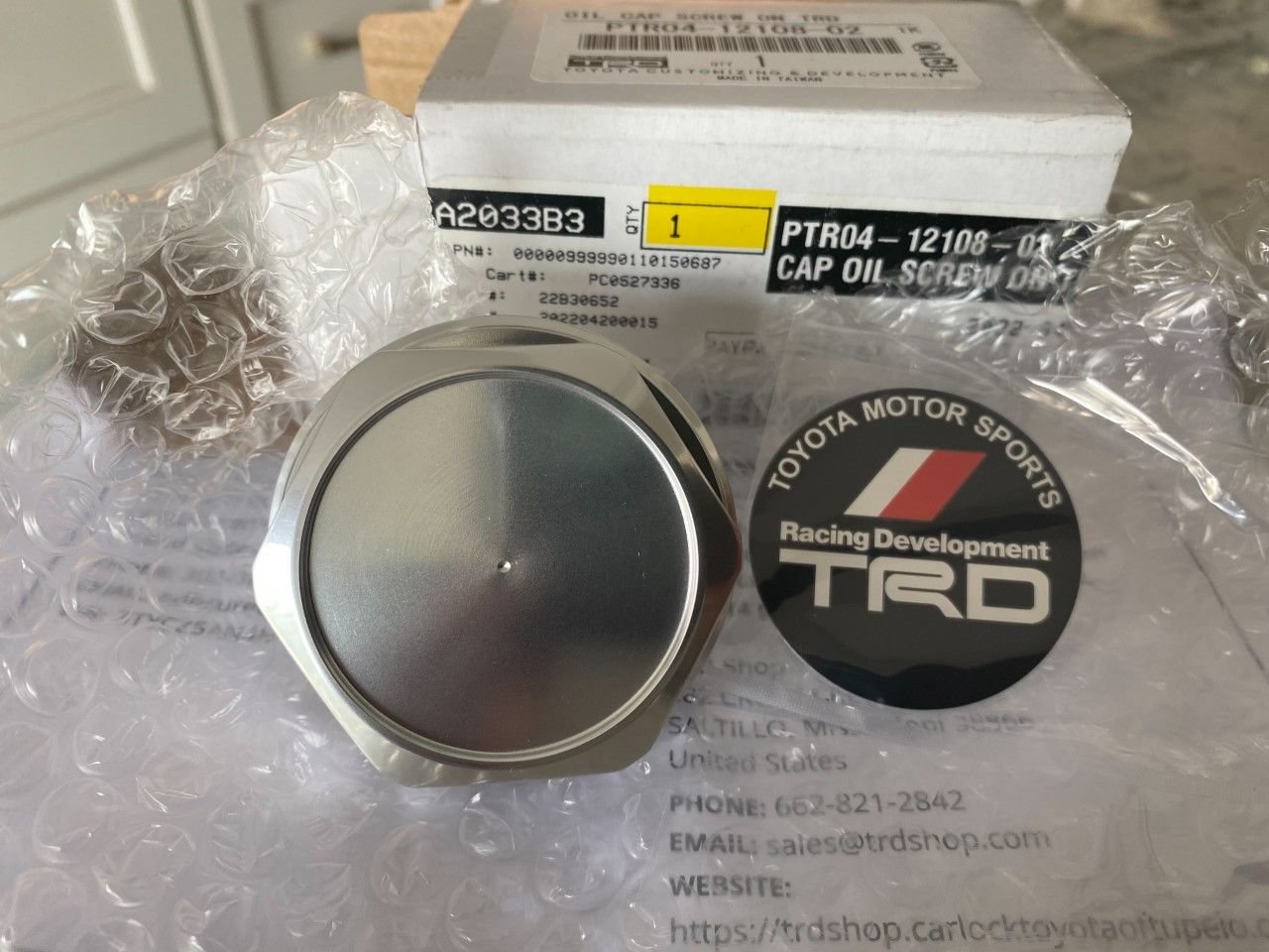

    TacoTime55 TT58
    Sep 28, 2021
    #378314
    9,204
    Ed
    Delaware
    2021 Midnight Black TRD Sport AT/DCSB
    TRD Lift,OTT Tune, LED HLs,TRDSkid, TalonCAT
    I've upgraded to a TRD Oil cap and you're right, it does take a fist grip to take it off! lol
    But previous cap and current cap have not self-twisted off.
    Williston and MGMDesertTaco like this.
