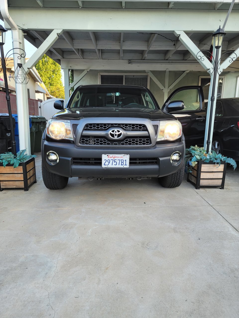

    Currently drive a 2011, 5 lug, Double Cab and it's been treating me great. Yeah I know, 5-lugs suck compared to any 6-lug Tacoma, but it's done everything I've needed it to so far. I don't go heavy wheelin', just weekend-warrior camping on fire roads. Please leave negative comments elsewhere.
    Here's the 5-lug Slug

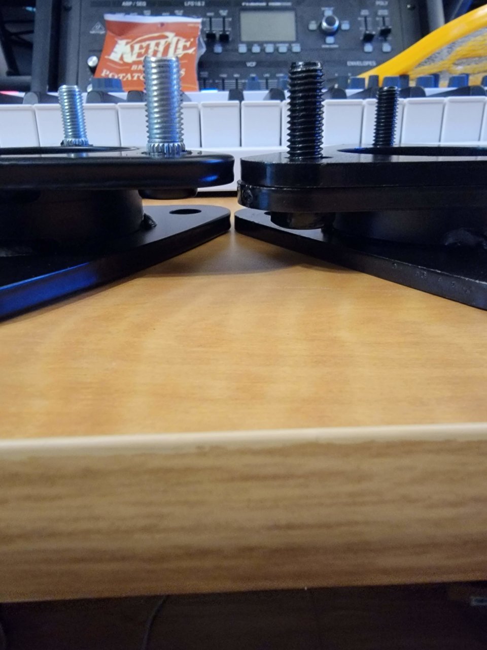

    After doing some research, I found Torch Off-road, which makes the "eBay" version of the Readylift spacer.
    Readylift advertises its lift as a 2.75" lift. Its spacer measures 1.25" tall with the considerably better build quality. See below.
    Torch Off-road somehow advertises a true 3" lift. Their spacer is actually shorter at just under 1" tall BUT they include a 0.25" spacer plate which raises the height of the spacer to just under 1.25" tall. See below.
    ^Torch Spacer w/o plate
    ^Spacer
    ^Spacer + Plate
    When you add the plate to the Torch spacer, the two spacers are almost the same height, with the Readylift spacer a millimeter or two taller.
    Finally, when you add the plate to the Readylift spacer, you end up with a spacer that is 0.25" taller than either kit would be on its own.
    How come the Torch Offroad kit can advertise 3" while the Readylift kit advertises 2.75" if the spacers are essentially identical? If anything the Torch spacer is a mm shorter.
    Math time: Let's assume that the Torch spacer (with plate) is 1.25" tall and the advertised lift is 3".
    1.25" divided by 5 is 0.25"
    3" divided by 5 is 0.6"
    Please correct me if I'm wrong, but I believe this roughly translates to every 0.25" of spacer = 0.5" lift (rounding down).
    If Torch Off-road can include the spacer + plate combo and advertise a true 3" lift with no issues during practical use, does anyone see any problems with adding the Torch Off-road plate to the Readylift spacer for the added 0.6" of lift? With all things considered, this is only adding an additional 0.25" to the Readylift spacer.
    This would however mean that, in a perfect world, the Readylift Spacer with Torch Offroad Plate would provide roughly 3.25" of lift as opposed to 2.75". With how few options there are for our trucks, this is enticing but by no means a dealbreaker.
    0.5" isn't a whole lot unless we're talking down there ;) ....then it's HUGE.... right? RIGHT??!??

    The only I issue I can foresee is clearance with the UCA/Strut Coil. The Readylift spacer already brings them really close together and there's a chance that the Torch plate/Readylift spacer combo will cause contact between the coil and the UCA at full droop. Unless someone is selling Total Chaos UCAs 88500, the ones that have been discontinued for years now, there will be no solution to this clearance issue if it arises.
    FYI:
    I'm not committed to this plan and still have the option to return the Torch spacers unless someone wants to buy them off me haha. Mostly just brainstorming while other work gets done.
    I'm well aware spacer kits shouldn't be stacked, but this is a plate that is intended to be installed on a spacer either way. I have access to a space where the work can be done for free so I might try installing the plates just to see if there are any clearance or binding issues. If it works I'll definitely make a follow-up post! Worst case we take them off and go with the Readylift spacer as is.

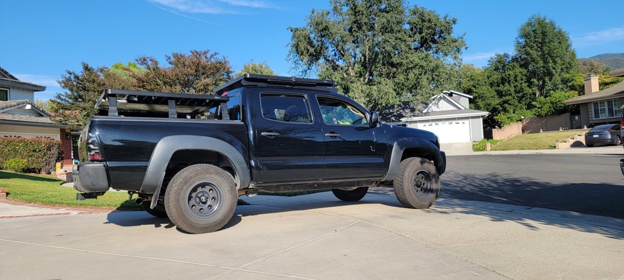

    Nearing completion!
    Racks and gear are getting outfitted little by little.

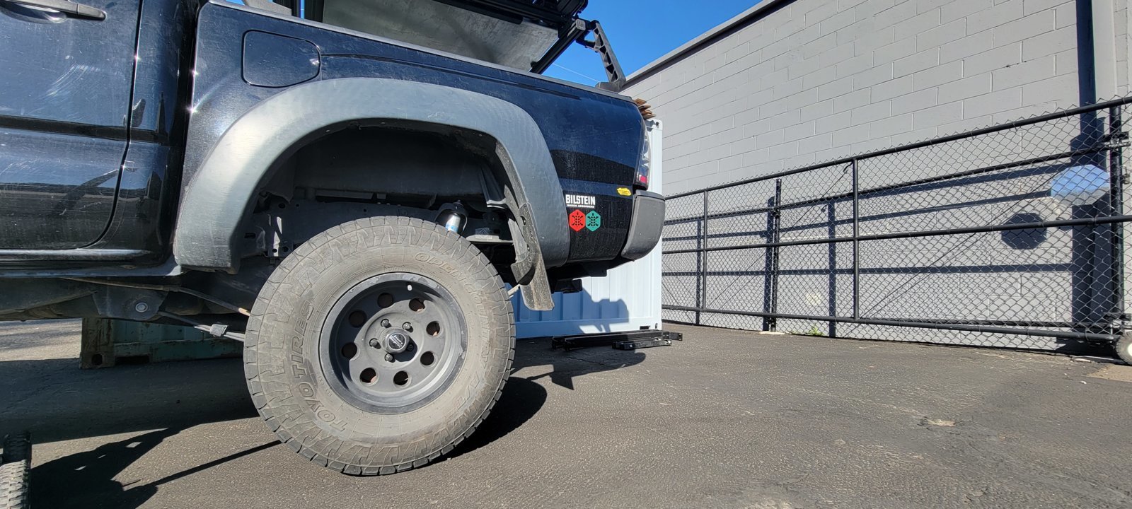

    Lift installed on front and back. Wish the back could be ~1.5" taller so if anyone has any tips on how to achieve this, I'm all ears! I'm thinking of doing the Archive Garage shackle flip and shackle lift.
    I heard that the AAL is kind of stiff, but can be remedied with a slight load in the bed. The bed rack and tent together weight roughly 150lbs, so this constant weight actually makes it a really smooth ride.
    I'm on Toyo AT3s, 265/75/R15 which come out to roughly 30.5" (that I am guilty of calling 31s) and yes, they do still rub a bit off-roading when the suspension is flexing.
    Had to replace the sway bar end links after busting the bushings, replaced with MOOG end links for our trucks.
    I also upgraded the 0.9 (~13psi) bar radiator cap to a 1.3 (~19psi) bar TRD radiator cap. I was having overheating issues on long drives but this solved all of my issues.
    I even got a 1500 mile road trip in with no issues whatsoever! My biggest gripe is uphills, but what can you do when you have less power than a Camry...
    I'm considering doing a 3rd member swap from a T100, though I'm not sure it's even worth it for me, as I'm in no rush to get anywhere like that. If it means going 45-50 mph uphill behind the 18-wheelers, so be it. As long as I'm on the road!
    Other than lifting the rear to be level with the front I plan on adding Coil Sumo springs to the front coils, and standard blue sumo springs in the leaf springs, because I found myself bottoming out often on trails going above 15mph, and Sumo Springs are the most cost-effective way to soften bottoming out.
    Didn't get stuck in any mud, but it was pretty funny when I got stuck in the sand on the beach. I got myself out with MaxTrax. Worth every penny and I highly recommend the investment to anyone who likes to go off-roading on their own.
    Since this trip, I've also installed the Alpharex Taillights, a lightbar, and some more rack gear.
    Not gonna lie, when I've got the Water tanks, Jerry cans, storage boxes, rooftop tent, and a bed full of more gear, this thing barely gets up to speed, but as I mentioned, as long as I'm chugging along, I could care less what pace I'm going.
    Ask me anything!

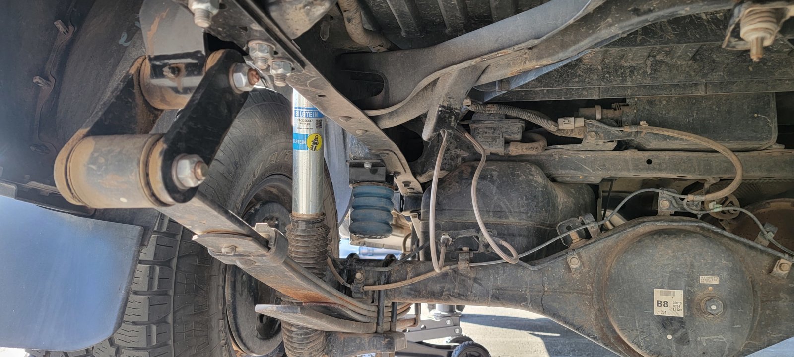

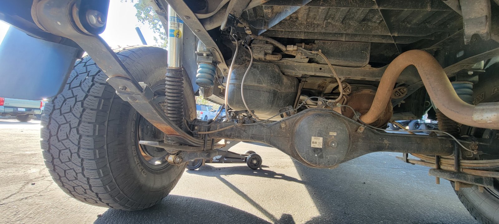

    Update on the Slug!
    Bilstein 5125 rear shocks and extended brake lines installed! Finally achieved 2" more droop with the shackle flip and these shocks.
    Regular height sitting under it's own weight - 35-degree shackle angle approx
    Used a Jack to lift the Driver side until full droop in the rear: Perfect 0-degree full droop shackle angle
    Helps level out and support the new rack and awning setup!
