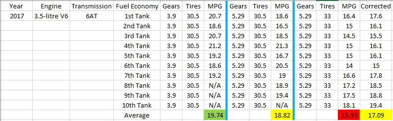

    07/07/2019 Update:
    Below is some fuel data. I will update the second post at the beginning of the thread but I do want to caveat what I learned about the tires and gear combo and fuel economy. As @In4aride mentioned above the truck just does not like certain speeds.
    I found anything over 65mph really began to tank the fuel economy. My numbers appear mildly misleading because I ran mostly 75-80 on the way up to Montana and you notice that I average about 16 mpgs during that time. I was learning how the truck performed during this time. Additionally I-25 north into Wyoming and MT is surprisingly very hilly with long steep grades which I think contributed to the mpg loss. Even at those speeds the truck was usually sitting in 5th and occasionally saw 4th and 6th. However on the return trip we set cruise control around 65-70 and took 191 most of the way to I-80 then I-25 and you can see that we averaged about 18.6 mpg.
    Conclusion:
    Gears alone will result in about 1-mpg loss. Moving to a 33" will result in an additional 1-2 mpg loss. I have no data for stock gears and 33" or 35" tire.
    I would expect someone to get anywhere between 15 - 18.5 mpgs with 5.29s and 33" tires depending on driving habits, load etc. Could be more or less.
    I'll also note that I did not fuel up at a specific point each time, I filled up depending on where we were an availability of service stations so some fillups were half a tank, 3/4 tank, etc. However all calculations were based on miles driven and gallons filled.
    The Corrected MPGs take into consideration a 7.27% change in tire diameter.
