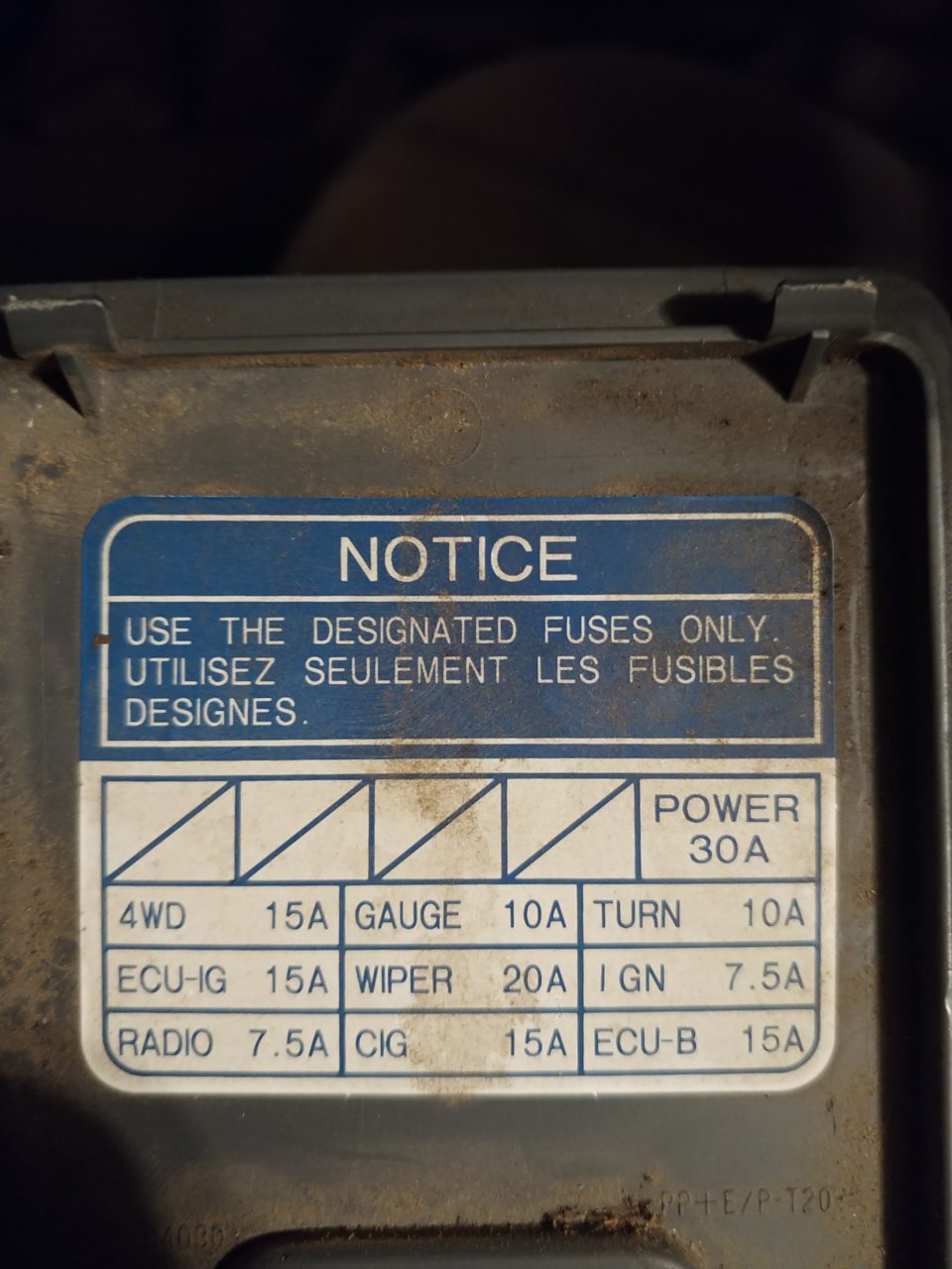

    Thanks for the info. All i have messed with is under the hood in the relay/fuse box where are the inline fuses located and does anyone have a schematic on the under dash fuses my cover is missing im gonna try and pick up a haynes or chilton manual on it for the wiring but they usually leave alot to be desired also not mentioned in the op the cel is staying lit with the key off any idea on that searched on it with no luck

    Idk if 04 is different then 97 but here

    May or may not be but it gives me a starting point thanks for the pic

    Here's a pic of the one from my 96...
