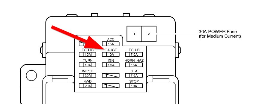

    Different year gave different fuse locations (Thank you Toyota). I do not have diagrams for 2001 model but it looks like 2001 has the same fuses setup as 2003:

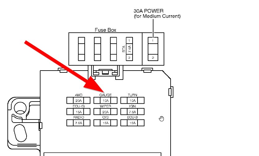

    2000 Tacoma has different setup:
