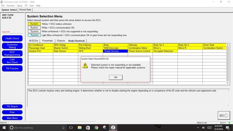

    I have also followed the instructions to the T and was able to finally connect the vehicle to the laptop using the mini cable and software. The issue I have is when I go to program the smart key for my vehicle I get an error message:
    This is on the selection screen after you connect the vehicle and select your make and model of the car, and then select "Smart Access" to program a smart key.
    Does anyone know how to resolve this issue? I am trying to program a backup smart key for my Lexus IS250 2007.

    I did not run into any virus warnings despite scanning everything with Kaspersky, so I wouldn't trust it when you are getting warnings.
    I have had a similar issue with the techstream program - mine will not display or clear TPMS codes, but will display live data and allow sensor ID's to be programmed. I suspect these few flaws have something to do with where we "aquired" the software. I'm really not sure.

    I spent the greater part of my day trying to get it working and I think I've finally hit rock bottom of trying to program a backup key for my Lexus IS250 2007. I think I'll end up taking it to a locksmith for the 70$ job since I already have the key ready to be programmed. It will likely take him less than 15 minutes.
    Perhaps in the future, I'll give it another try again on an older laptop that runs Windows XP.
    Thanks for the help.

    I know that feeling too well. I have not tried using mine to program a key yet, though I think the options are different for with a Tacoma and Tundra than what your screen shot shows for your Lexus. the good news, it that Techstream itself is the easy part - it's the MINI-VCI driver installation that is the hard part. Perhaps there is a more current version of Techstream you could download and install.
