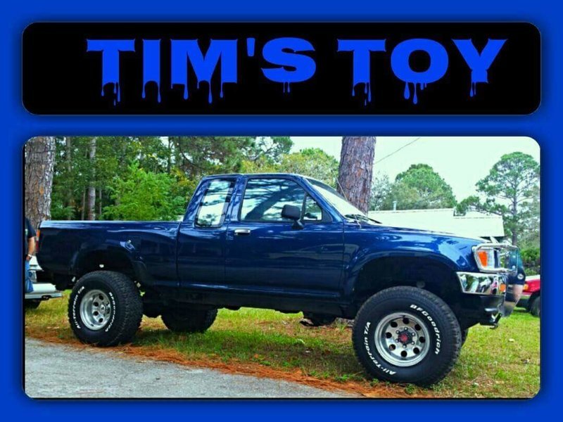

    Exactly what mine is doing! But I don't want to sell it!received_1293804923997667.jpg
