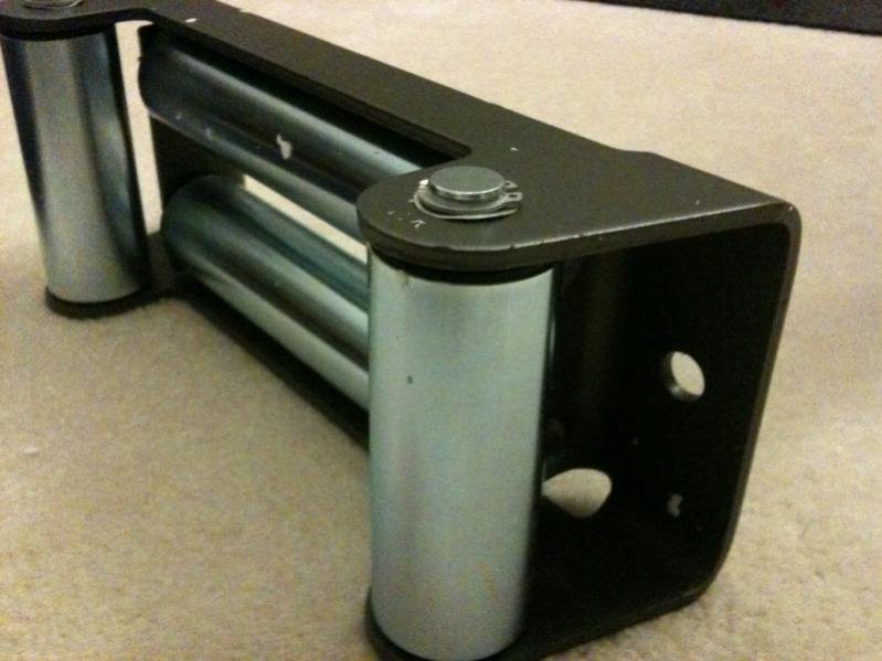

    I recently bought a 12,000lb winch for my 2nd gen and got her all mounted up and purty looking. Mostly. The included Fairlead is the larger four-roller style which I installed but I'm not sure I like the look. My bumper is an All-Pro and it kind of hangs off a little on the bottom edge and looks a bit... off. I also have a hard time fitting my plate up to it w/o it hanging off of the top. I've seen the smaller aluminum single piece Fairleads and I'm wondering what the differences are functionally speaking. To me it seems as though the roller ones probably do their job a little bit better at the expense of larger size and moving parts that could fail eventually. Is it the fact that I have a 12,000lb winch so the smaller one-piece style isn't rated for that use? The smaller one looks more streamlined but maybe it doesn't do quite as good of a job but has no moving parts to fail. Am I missing anything? If that's the case and the sacrifice in performance is marginal I may source the smaller style and sell this roller-style as it would fit my setup better aesthetically.
    Thoughts?
    I'll add photos and make it a poll just to keep things interesting.
    Roller style:
    Solid style:

    The solid is for synthetic line. Roller for steel cable line

    So if I wanted to run the solid Fairlead I'd need to switch my line to synthetic. That's pretty simple I guess. Looks like I'll be running the roller style because synthetic line is expensive and less robust from what (little) I've read.

    There are (were?) steel hawse (solid) fairleads. The base model winches typically come with them. The steel line can be used with the steel hawse fairlead.
    Either steel or aluminum can be used with synthetic. But it needs to be a new fairlead when the synthetic is installed. The steel line will will gouge and scrape the fairlead, which if then used with synthetic will likely cause extra wear or completely damage the synthetic line.

    you can use a steel hawse fairlead. not as good for the winch line in the long term, but unless you wheel A LOT and use your winch just as much, you line will likely deteriorate from rust/exposure to the elements, before it wares out on the fairlead.

    Get synthetic rope and an aluminum fairlead, it will also shave a bunch of weight off the front of the truck. The safety advantages of the synthetic rope are pretty obvious as well.

    I've used steel solid fairleads without issue with steel. Has to be steel and no aluminum with cable. I've seen synthetic lines get wedged in roller fairleads, plus in my experience I've seen roller fairleads get wedged up themselves and not roll at all. Plus they stick out a lot further.
    I'd have synthetic if I had extra money. I've seen it break in person before and it's super safe. Just falls straight down and piles up in a little coil. You do have to take extra caution and watch the line to make sure any spots that are hitting the ground/rocks are covered by the sleeve.
    I had a roller for a while since that's what my winch came with, but now I have a solid one.

    $200 to $300 for a new synthetic line with a hook or thimble already spliced onto it, and another $30-$50 for an aluminum hawse. depends on the brand, and where you buy from.
    roughly $50 for a steel hawse fairlead that is compatible with your steel cable.
    either option can be installed without removing the winch or your bumper.
