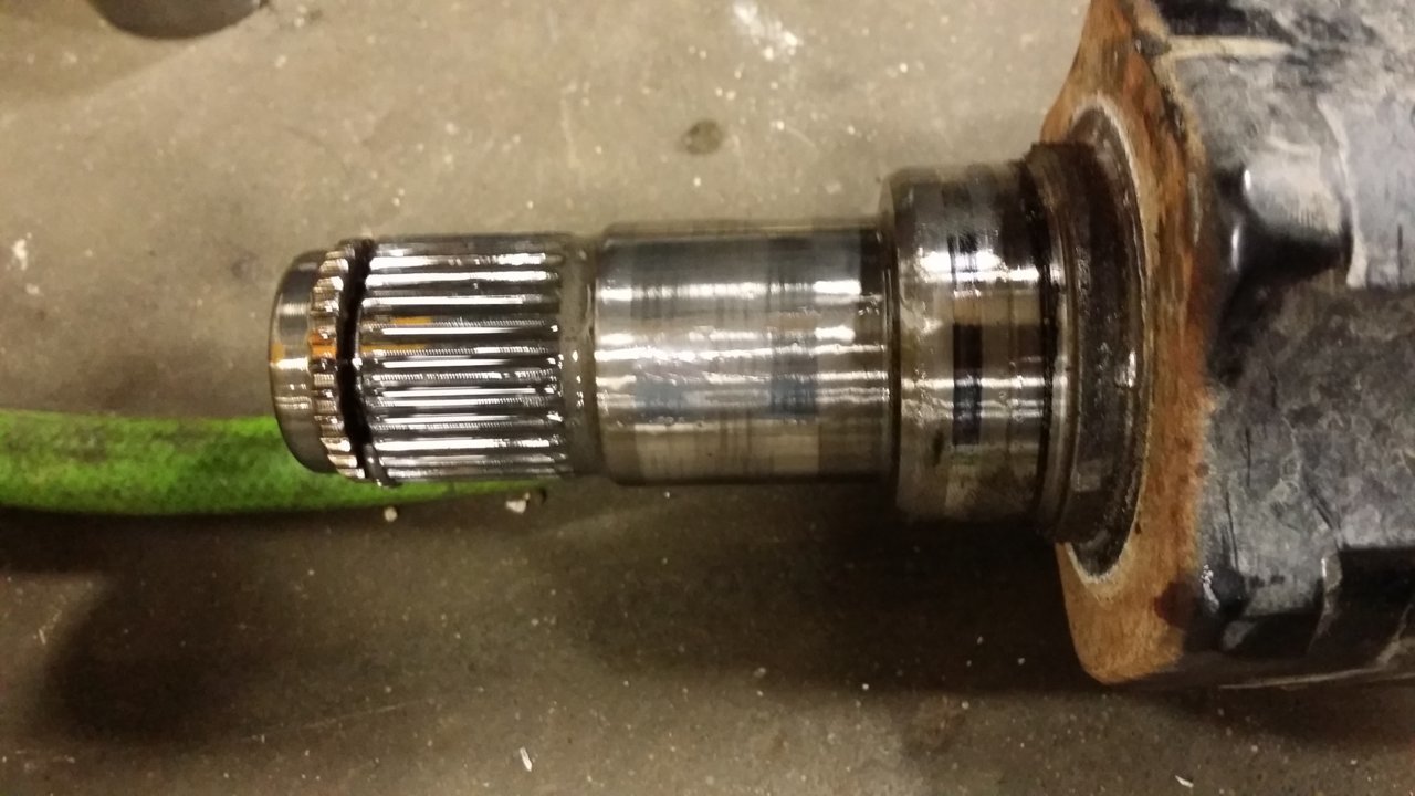

    This was my left front axle at 7k miles. The needle bearing is not able to be made to such tight tolerances so there is play in the left front axle. As the axle wobbles around spinning, it wears the shiny spots. If it was making even contact, the wear would be even. The ecgs bushing is made to a tighter tolerance and better supports the axle and after installed reduced play from about .015 to about .002 in the axle. 55k miles and 5 years later still zero play.
    The issue isnt really even the needle bearing, it's the fact that they are trying to make it do 2 jobs as there isnt room for a carrier bearing on that side to support the load of the axle. It's a design and space problem, fixed by replacing the bearing with something solid, in that case a sintered bronze bushing
