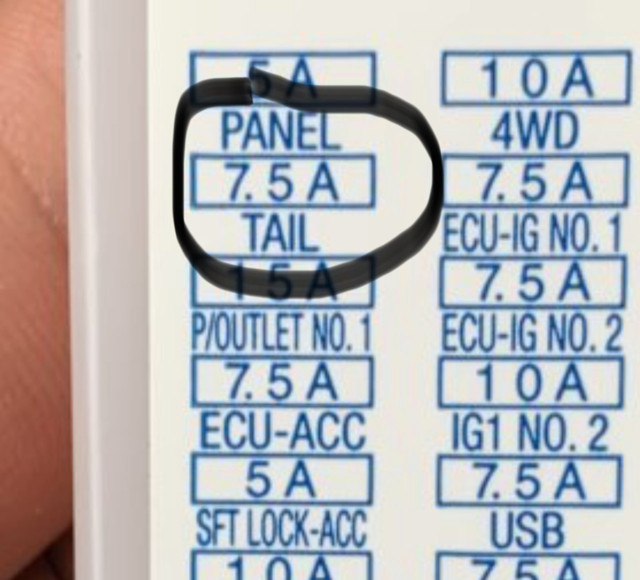

    It was TAIL 7.5 that blew up

    Power goes to tail, marker, and license plate from that fuse.

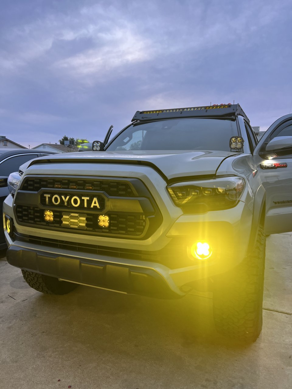

    Those headlights are not OEM. I'd disconnect them for a test.

    What do you hunt at night that requires all those lights??

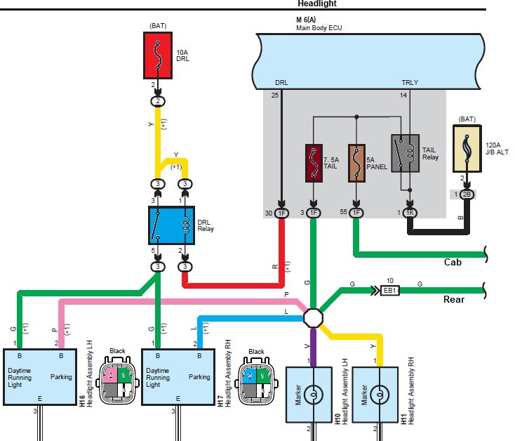

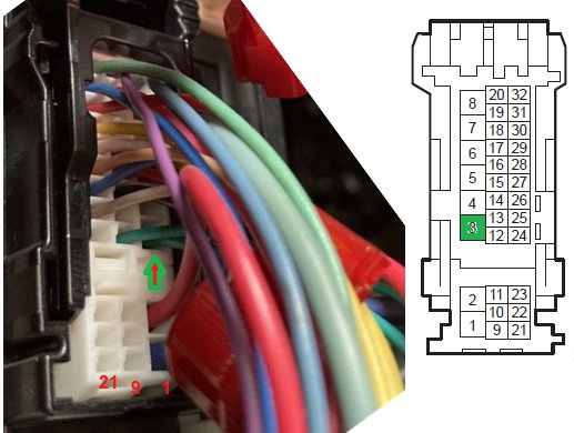

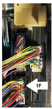

    With a meter, verify that you get voltage at connector 1F position#3 (green wire) when you select parking/tails on the steering light stalk switch.
    CarlosTRD2021[OP] likes this.
