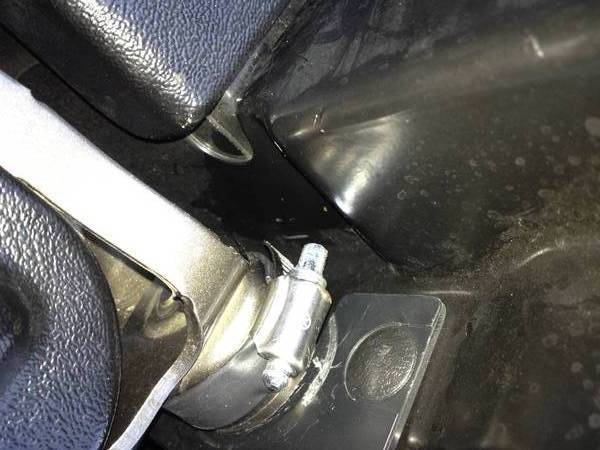

    Are those zip ties? If so, you might consider changing them. Those are easy to break off with a knife or screwdriver

    They are indeed zip ties. Several upthread have done the same mod. I really tried to get that tail gate off afterwards. Nope not "easy" to get it off with a knife or screwdriver, but I will say it's has the same degree of difficulty as does the hoseclamp if one wants to get it off. It's designed to be a deterrent not a complete stopper. Currently I have the zip ties and a cablelock securing the tailgate. In addition, I also have the GateKeeper http://www.jimmijammer.com/Product,%20GK.htm on order. When I put the GateKeeper on I will cover the zip ties with it.

    I bought my Tacoma last month and this was the first thing I did to it. I had to take off for a few weeks the day after I took it home and was worried I'd come back to a tailgateless truck. Luckily it was still there and on went the "keyed" hose clamp installed from underneath to make it a little more challenging. The ruber shrink wrap was a good tip to prevent marring. I also did the cable washers and loctite. Thanks for the tips.

    "keyed" hose clamp with shrink wrap installed through the bottom
    Also did the washers
