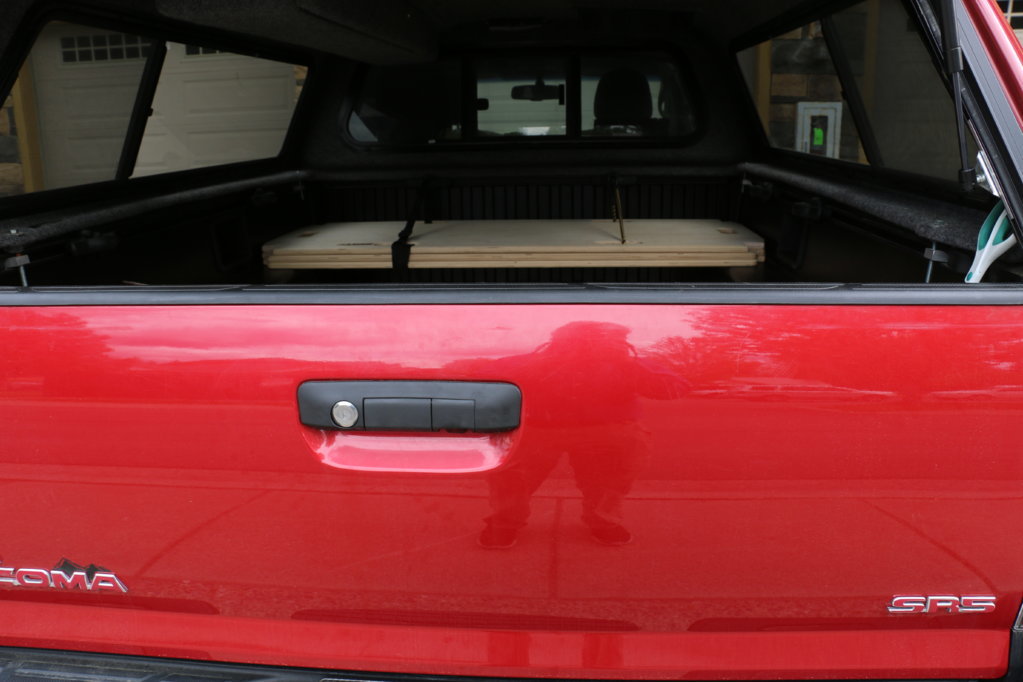

    Hi.. I installed my PL5400 pop and lock with bolt technology so you can use your ignition key. I bought the truck and it came with a PL5300, but didn't come with a key. I contacted pop and lock about their PL5400CONV which is the new cam lock with BOLT, but it doesn't physically fit...it's too big of a lock cylinder. So I decided to buy a new PL5400 and not their painted model because I heard about reliability issues...so why pay more for it...I can always paint it later.
    I looked at their video https://www.youtube.com/watch?v=s48fimgxYI8 and followed their steps. The issue I had was step 3. They tell you to flip the driver side tail gate latch rod and I finished the install...took about 10 to 15 minutes for the whole thing. The thing is this flip rod is kinda silly...you have two pivot points and then a bent rod and it takes away the clean opening action you would get from the factory tailgate handle set up.

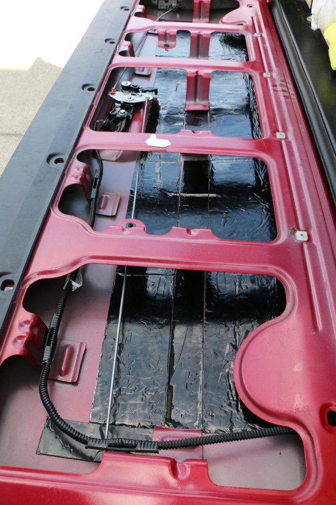

    So I did this instead of step 3 I modified the rod (excuse the finger blocking the photo):
    It sucks when you don't have the tools you need...in this case a vise. I took the rod and bent it straight and then I eyeballed the new point to bend the end of the rod to attach to the pl5400. It took about an hour to do this...I just had a C clamp and pliers to bend and make straight close to 90 degree bends. The end result is the picture above. If you have a vise and good bolt cutter, should take about 10 minutes for this mod.
    I should have but didn't take a picture of the original rod before modified, but here it is installed. So doing it this way instead of pop and lock's way...there's no rod rubbing/making contact with your tailgate (leave or add all the sexual innuendo you like)
    up close..
    So now...I added lithium grease to all the moving parts of the tailgate and now it works as good if not better than factory... I don't see anything breaking now...hopefully the BOLT lock will continue to work. It feels good that the tailgate is a bit more safe....that plus Mobtown's tailgate skin.
