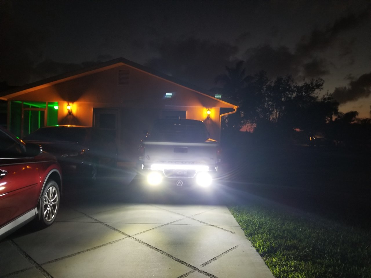

    I am running the Opt 7 Sequential and love it. I used some plastic velcro type stuff, much like the Command brand to attach it so I can remove it if/when needed as it does cover the spare hole. I did not want to use the screws and clips that came with it.
    Pics are from my blinker & Reverse relocation mod.
    Brake
    20181016_073757[1].jpg Reverse:
    Hazards

    I used this to do the wiring. Simple plug in and zip tie slack. There is a 5 pin version available that I did not think to purchase at the time. IF I were to do it again, I would buy the 5 pint and plug the reverse there as well.
    This is the bar I have on my truck, installed March 2017 1 dead LED at this point.

    I had the bar prior to adding the pods, so the reverse for the bar is tapped to the driver's side tail light harness. I tapped in a wire and ran it down with a bullet socket on the end and added a bullet connector to the light bar harness. I mostly did this because I had a different brand bar, initially, on my 1st gen that failed so I replaced it with an earlier model of the Opt7 bar. That bar was still fully functional when i traded the truck in, but it was attached via 3M tape so I just bought a new bar for the new truck.
    If you got the 5 pin rather than the 4 pin T-harness the reverse would be part of the plug. So you would only need to add a bullet connector to the wiring for the bar. I remember another member posted they did exactly that.

    I have had a bit over 4 years between 2 Opt7 light bars. So far all the worst failure I have had is with the current bar with 1 LED that had failed.
    The bars I have had fail on me before were non-branded generics for far less money and equally low quality. When they failed I simply disconnected them. I have never once had a cop pull me over or hassle me over any tailgate light bar.
    Of course is it the option of the buyer to take on any risk involved. I see them as an added safety becasue other drivers get more indication of my turn or stop.

    Yes this bar is water proof. the ONLY possible complaint I could have is that is is an aluminum channel that the LED sits in. The channel is filled with clear silicone which is by nature soft. The good, it will not crack and break. The bad, if one backs into a branch or brush there is a small chance of damage to the silicone, this is assuming the offending branch made it past the bumper, stayed under the tailgate, and was sharp/hard enough to gouge or cut the silicone whie you were backing up and did not see it or care it was there. I see that as a low likelyhood.

    The T harness plugs into your combo hitch plug behind your bumper. The bar comes with a 4 pin trailer connector. Plug that into the 5 pin as if it were a 4 pin. The remaining open hole is reverse. Add a bullet connector, of correct size (blue I think), and plug that into the last hole of the 5 pin.
    No tails to be pulled, and if you ever need to remove it just unplug it and move on.
    The standard 5 pin trailer has ground, turn/brake, turn/brake, running, reverse. As I recall.

    UPDATE:
    Now it is April of 2021 and the Opt7 bar I put on my 2017 in late March 2017 still have no failed LEDs and continues to operate at 100%.
    The Opt7 is an aluminum track which runs the length of the LED strip, it is shaped like [, the track is filled with silicone covering all of the LEDs. Pretty solid and sealed construction. It is still listed on Amazon today for the same price that I paid.
    Seems to be 100% waterproof in my use, though I will admit I have not kept it submerged for 4 years, of course my truck is normally driving on roads that are on land. In the 4 years there have been boat ramps, tropical storm flooding, multiple trailers pulled, Florida rains, washed out roads, and a lot of washes.
