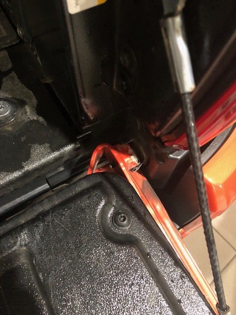

    I am beyond frustrated at Toyota (Fred Anderson Toyota in Raleigh NC). This plastic bushing cracked and fell apart causing my tailgate to misalign bending the bottom corner of the gate itself. They stated they do not know if the bushing can be replaced. I have had several Tacoma's and this has never happened before. The service manager stated they changed the design because people complained they rattled in the previous generations. I never noticed it. They stated it was user error in opening and closing the tailgate or a "forced" effect. I only carry hockey bags so I am not certain how it could be "forced". Dealer refused to give me the regional Toyota directors number.
    This is not traditional Toyota quality or service.
    Anyone else either see or resolve this issue?
    Thanks,
    Dave

    @tacitos has a great write up thread on the very problem you are having:
    https://www.tacomaworld.com/threads/2016-tacoma-tailgate-replacment-bushing-66143-04020.452351/

    A bit late, but I found a quick and cheap fix from my Toyota Dealer thanks to a parts guy who took the time to dig into the issue and what I needed.
    Part Number #66143-04021
    I have a 2016 Tacoma with the new hinge setup (see https://www.tacomaworld.com/threads/2016-tacoma-tailgate-replacment-bushing-66143-04020.452351/). After discussion, diagram mapping, and actually showing them a repair video and my tailgate, they found the specific piece that I needed for the assembly at a very cheap cost. It was hidden within the hinge and bushing assembly for their parts list in the computer in the hinge dampener assembly itself. My receipt cuts off the description after "HINGE, SIDE" so I don't have the full name but the part number should find you what you need and costs less than $10. I ended up buying a couple of extra just in case.
    Hope that helps future folks and gives you a couple of options to order the re-manufactured piece from the other thread or head to the dealership with the part number listed above.

    This is nothing new. That bushing is a wear item that dies every 16months or so especially in cold climates. For early 3rd gen it's totally replaceable and takes 10 seconds and no tools, you can do it one handed.
    I changed mine out yesterday.
    For later 3rd gen its an updated part number that is not compatible with early 3rd gen tailgates.
