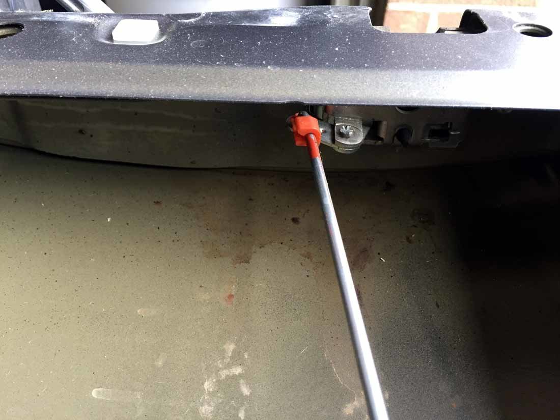

    Okay, this one has me puzzled.
    My truck is a 2017 TRD Sport with the factory tailgate lock that is actuated with the key fob and connected to the doors when they lock/unlock. Now, for the last two years, it has worked flawlessly. I press the unlock button on the fob and all doors plus the tailgate physically unlock with the tailgate specifically making a loud, ker-chunk sound.
    The tailgate, in-particular, has a feature that will automatically re-lock the doors if it is opened but they aren't. Again, historically, this has all worked normally and as expected.
    A few weeks ago, I hit the unlock button on the fob, heard the ker-chunk of the tailgate lock release, pulled the tailgate handle annnnd; it was still locked... WTF? I hit the lock button on the fob, then unlock again. I hear the tailgate lock actuate with both presses of the button, yet the handle does not allow me to open the tailgate.
    When this happens, the only way I can open the tailgate is to physically insert the key into the tailgate lock cylinder and turn it to allow the handle to operate.
    Please tell me I'm not going mad and someone else here has also experienced this weirdness...

    Sounds like the actuator detached from the mechanism. Take off the tailgate skin and check. It’s a t30 torx

    If it’s the OEM one, there’s a push on retainer thing that attaches the actuator to the locking mechanism. I’d guess that popped off

    Plastic retainer clip likely broke. Easy fix

    Happened to me on my pop-n-lock. No hardware came apart, but was very dusty. I cleaned it and sprayed some silicone lube over the moving pieces and it's been good for at least 2 years now.

    Hmmm... everything seems latched and where it's supposed to be.
    That slide mechanism isn't pushing the latch far enough on the press of the unlock button. The video shows the actuation... or lack thereof.

    Thanks Slowpoke16...
    Solveded... just needed a light lube at the slide junction where the springs move the latch.
    Dumonde Tech Lite to the rescue.
