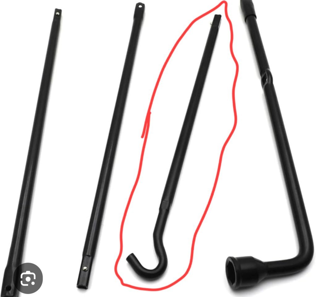

    ACEkraut
    ACEkraut Well-Known Member
    May 11, 2014
    #129627
    4,490
    Aaron
    Durham, Maine
    2014 DCSB TRD Off Road
  13. Jan 4, 2024 at 7:31 AM
