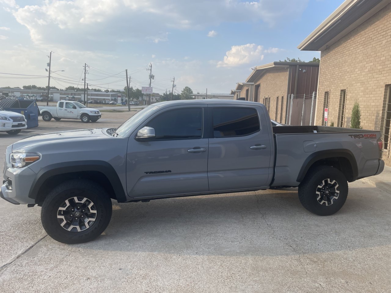

    I had Nano-Ceramic Tint installed on my new-to-me 2020 DCLB 3G at Texas Tint Masters in Houston, TX. I learned some things through the process and want to share. The tint shop had a tint meter and were patient with me which helped me make this a little more scientific!
    The 3 vocab words to know:
    • Visible Light Transmittance (VLT) - Lower % means darker. 5% = Limo tint / 100% = Transparent glass
    • UV Rejection (UVR) - Higher % is better rejection (UV = skin damage + heat)
    • Infrared Rejection (IRR) - Higher % is better rejections (IR = heat)
    Initial Tint Specs
    • 100% (Factory) Windshield
    • 20% Front 2 Doors
    • 28% (Factory) Rear 2 Doors & Rear
    The truck already had some type of ceramic tint (~20%) on the front 2 doors. It matched perfect to the rear dyed factory glass from the outside, from the inside you could tell the difference if you REALLY cared but it was close...
    upload_2023-9-20_23-44-21.png upload_2023-9-20_23-52-31.pngupload_2023-9-21_0-3-22.pngIMG_3378.jpg
    For those unaware, the rear glass in the Tacoma comes from the factory "Dyed" at ~28% VLT and it actually has "decent" UV Rejection on paper (94% UVR / 90% IRR) according to the tint meter.... HOWEVER
    Texas summer had like 50 days over 100F this year... sitting in the front I was tanning and sitting in the back I was cooking. Also the glare through the windshield was unbearable. Sweaty drives everywhere I went with AC on max. This level of tint might work great for folks who don't live in a frying pan, but not in Texas.
    Final Tint Specs: XPEL PRIME XR PLUS
    • 55% Windshield
    • 10% Front 2 Doors
    • 30% Rear 2 Doors & Rear
    upload_2023-9-20_23-53-43.png upload_2023-9-21_0-13-5.png upload_2023-9-20_23-54-17.png upload_2023-9-20_23-54-52.png
    It was critical to me for the truck to have a uniform tint look, I did NOT want multiple shades of glass, personal preference. I worked with the tint shop to match the rear to the 10% fronts. To approximate the VLT when overlaying tints you multiply the VLTs in decimal form. 30% over the factory 28% rear would produce just under 9% (0.30 x0.28 = ~0.09).
    To test this, the tint shop actually took different sheets of the XPEL XR PLUS, placed them over the factory rear glass, and metered it. The result was almost spot-on!
    Overall I am super happy with the result. The nano-ceramic proved to make a huge difference when it comes to heat rejection, it is a much cooler ride now. The 55% windshield eliminates most glare, I only use sunglasses at sunrise/sunset. I love the look.
    FAQ:
    • Night Driving: 10% IS DARK AT NIGHT. In well lit areas (i.e. city driving) it is no problem at all. Backing into a dark parking spot does suck, but I plan on adding rock lights. The reason I did not go darker is because i actually plan on driving off-road at night... and I also hope to sneak by without too many fix-it-tickets :pray:
    • What would I change?: I really want to add visor/eyebrow tint for function, but I just can't convince myself that I like the way it looks.
    • Cost: Just under $900 installed. The windshield was almost 1/3 of that. Cheapest nano-ceramic in my area, lifetime warranty, super helpful, and they did a great job.
    • Can you see in?: It depends on the angle and the time of day. It is very difficult to see into the back seats. You can sort of see into the front seats from most angles, but silhouettes only.
    POST YOUR TINTS AND LET ME KNOW YOUR THOUGHTS!
