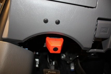

    Programming Step 1: Close all doors except drivers door. Leave open during programming
    Programming Step 2: Insert Original Key (the one your currently using to get around) and turn to the on position
    Programming Step 3: Insert SmarKeymaker into OBD Port
    Programming Step 4: wait for first beep. (1-15 seconds)
    Programming Step 5: Wait for second beep, this will be 3 quick beeps identifying (3rd generation) (1-30 seconds after first beep)
    Programming Step 6: wait for final long beep. this can take a little bit, so be patient. (30seconds to 1 minute) once we hear the long beep, we can proceed to the programming

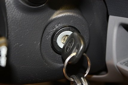

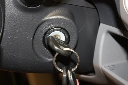

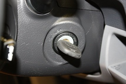

    Programming Step 7: Remove original key and reinsert, DO NOT TURN, wait 5 seconds and remove.
    THEN insert the new key, DO NOT TURN, wait 5 seconds and remove.
    Programming Step 8: Insert original key and turn to ignition ON Position and Lock position 5 times quickly. Remove Key.
    Programming Step 9: Close Door (you left it open,right?) then open door.
    Programming Step 10: Remove SmartKeymaker
    Programming Step Step 11: Test out and enjoy new key! :woot:
