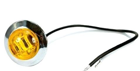

    I would just buy a pair of aftermarket small 3/4" round lights , install them and wire them to the turn signals.

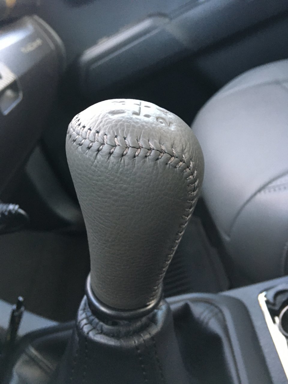

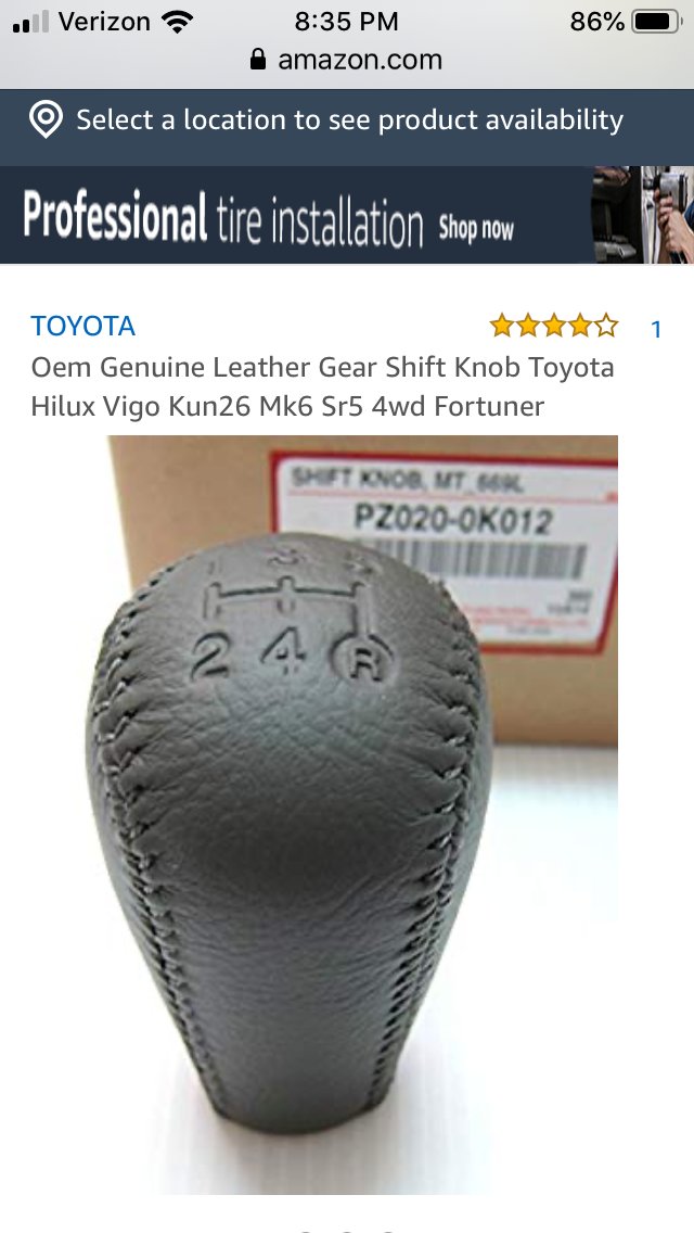

    I have a 2017 Tacoma. I like the looks of the leather Hilux shift knob available from Amazon. Do the Hilux and Tacoma have the same gear shift knob thread and pitch ?

    Yes. Both the Tacoma and the Hilux Vigo use the same 12 x 1.25 thread in their shift knobs.

    You are correct. The Hilux shift knob fit my Tacoma. Thanks again !
