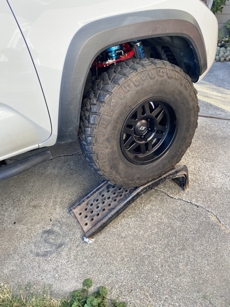

  20. Jun 29, 2022 at 7:25 AM
    #20
    Pete4x4
    Pete4x4 Well-Known Member
    Mar 27, 2020
    #323152
    105
    Frankie
    NorCal
    2014 4x4
    6112/5160 Dakar HD
    Installed 4.25 yesterday… seems real close to the strike plate… running HD Dakars with a shim underneath. Is this how everyone else’s looks?
