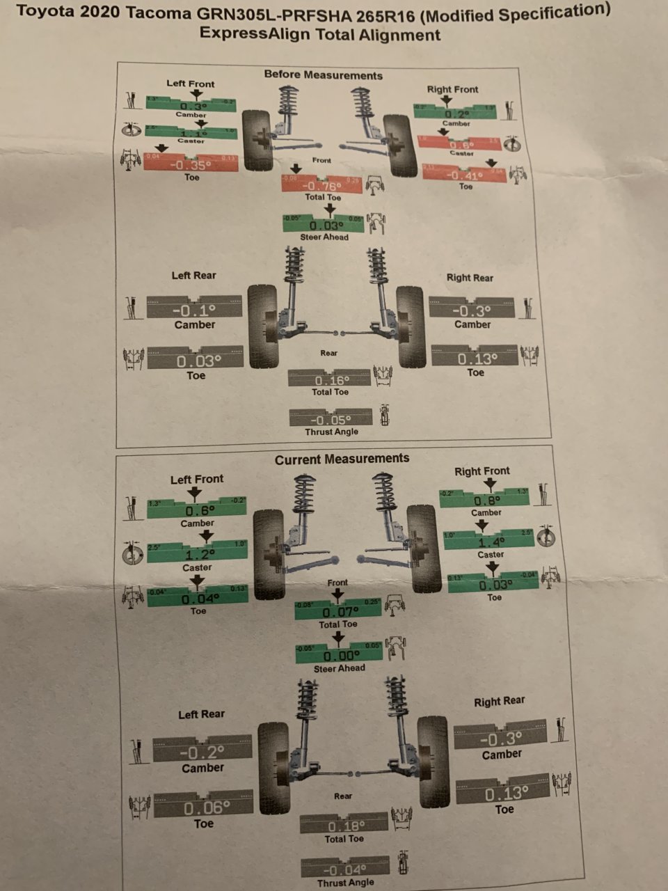

    I have a stock 2020 Tacoma trd off-road with about 20 k on it pretty new but I’ve noticed my tire have a positive camber and it really noticeable I’ve got alignments done at Toyota and they say it all to spec but my tire treads are wearing unevenly does anyone know what I could do to fix it

    If you don’t rotate your tires correctly you should see negative camber on the tire ware. But in saying that it will always depend on the psi you are running and how hard you corner. Without posting the actual spec of your alignment there is not much anyone can comment on.

    If I remember correctly, the alignment sheet I got when I did my lift said +1.3 was the positive end of the “in spec” range. Seeing how shitty some techs are, they would probably leave it alone even if it’s at +1.2, because that’s still in range. On a 30 plus inch tire, that can definitely be picked up with the naked eye. Maybe ask for the print out with the actual numbers, as mentioned above?

    My toes are pointing into the car that’s what I notice I have the print out I’m trying to see how to get the picture on here I’m new

    I also ended up with .8 camber after aligning with 2” lift and 265 75 r16 tire
    would that be ok? What I do not like is that the .8 it is noticeable.. doing chalk test on tires to see how tires would wear… definitely don’t want to wear prematurely the outter edge..

    positive camber will reduce your truck's wandering and the tendancy of it to follow the grooves in the road. The positive camber alone is not an issue, what i've found in my experience is that more than 0.04" of total toe and the edge the camber is resting on will start to wear. so negative camber would be riding on the inside edge and positive camber on the outside edge. However, also in my experience is that due to the low camber design of these trucks 0.06" total toe drives the nicest. You really have to compromise when doing alignments on these trucks. I currently am running +0.6* camber on both sides, 2.25* caster left and 2.75* camber right and 0.05" total toe. I only notice the edge cupping when I don't rotate my tires with my oil change.

    My numbers are:
    L
    camber: 0.08
    Caster: 1.4
    Toe: 0.05
    r
    camber: 0.08
    Caster: 1.7
    Toe: 0.05
    Are this healthy numbers?

    Ya they look seem fine, depending on what the roads are like where you live/ primarily highway or city I would of maybe added some more caster and a bigger split for highway driving because the truck probably wanders to the right a little if you let go of the wheel but otherwise no concern there. I wouldn't pay to get it realigned. If you really don't like the look, the least amount of camber that feels good in my opinion is +0.3* but I drive primarily highway, the roads here are deeply grooved from heavy trucks and I prefer the easier steering and better braking from positive Camber. If I lived in the mountains or somewhere with alot of curvy roads I'd probably try -0.25* or maybe even -0.5* camber for the advantages associated with cornering.
    Bottom line is if you are concerned something is wrong, it's not. These trucks are spec'd to have the tires pointed like that. If it's visually bothering you can get another alignment and ask them to maybe only put +0.3* of camber on both sides

    Thanks man! I realized I had basically zero knowledge about alignment until I started reading about it.. my primarily concern is/was premature wear on front tires.. I am on top of air pressure now with new tires and I’ll be testing different tire pressures and chalk test to see..

    YotaWerx Stage 1, Bumper light bar, Hood wrap, Roadmaster Active Suspension, Durobumps.
