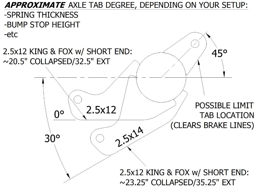

    • KIT ALLOWS FULL BUMP W/ 2.5" X 14" (23.5" COLLAPSED)!!!
    • Fits: 2.5" x 12-14" Smoothy/Bypass and 3.0 x 12" Smoothy
    • Puts the top shock eye high as possible, giving you max bump travel and ground clearance
    • INSTALL AXLE TABS @ MAX BUMP HEIGHT
    Archive Garage 2.5" shock relocation:
    https://archivegarage.com/products/...k-relocation-towers-2-5-x-12-to-14-mid-travel
    @Radflo Shocks 2.5x12 for Archive 2.5" Relocation, reference number:
    6SR-003-00 *Customers need to specify “1 inch shorter” lower rod end.
    BEST ORIENTATION FOR RESERVOIR ELBOW WITH COMP ADJUSTERS

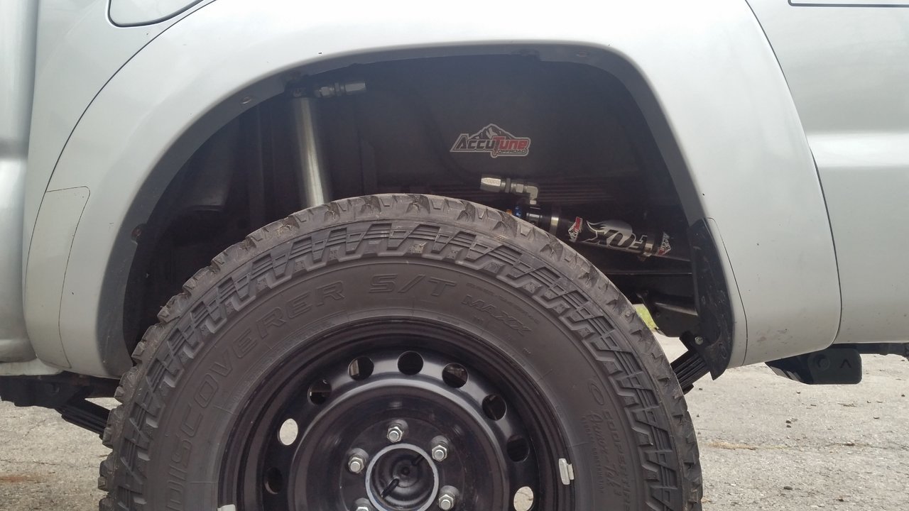

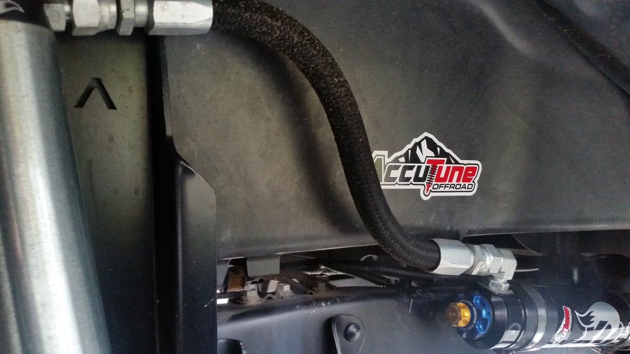

    Fox 2.5" Factory Series with Dual Speed Compression (DSC) adjusters valved and tuned by AccuTune Offroad

    This kit can do both 12" and 14", but the 14" on the SUA setup and trying to basically touch whatever axle bump plate you have on the frame rail requires a new lower/longer axle tab I made and offer.
    I just converted my truck to SUA with the Deaver U539/540 HD springs (same as TC). With my new Hammer hangers with 4.9" shackles, I'm getting potential for 13" vertical non-articulated axle travel, that is full droop to axle bump plate contacting factory bump bracket. I really haven't had time to measure it all out yet, and I need to weld in those new lower shock tabs I mentioned.
    So the answer to your question is 12" shocks will likely be limiting factor by a little bit, 14" is a better match to the springs/Hammer hangers, but 14" it is definitely a tight squeeze in the SUA configuration and getting big uptravel numbers (which also will probably require trimming stock fenders/fiberglass)
    It will also depend on your bump setup, this determines your travel potential. Full droop with the Hammer hangers is right before my stock 4wd driveshaft slip is fully compressed. What I'm saying is droop is maxed out at a measurement of approximately 15" from top of axle tube to bottom of frame rail.
