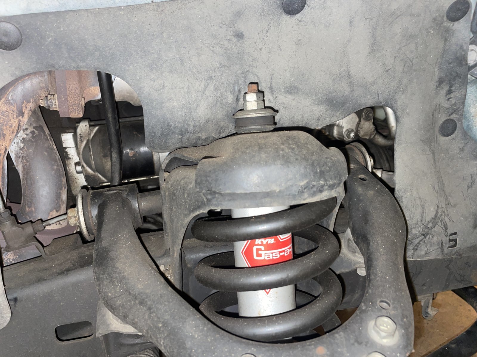

    I'm looking at getting a spacer to combat the left front fender being 1" lower than the right. I just had new shocks, control arms, and coil springs installed, and the lean is the same.
    This is the only one I found so far listed as compatible. I see it's only half an inch, but that's better than nothing.
    https://tacomabeast.com/products/1995-2023-toyota-tacoma-0-5-lean-spacer?variant=40646820167865
    Where are these installed on a 2wd 5 lug? Pics below are before the work but show the design. It's not a 4wd. Every install guide I've found is for 4wd.
    I'm afraid I might have to remove the control arm, coil spring, etc to get this installed? I just got back from a shop who had to take an extra day to get my new coil springs installed because none of the spring compressors fit right, and even then they needed 2 people to do it. So I'm doubtful I can mess with that safely.

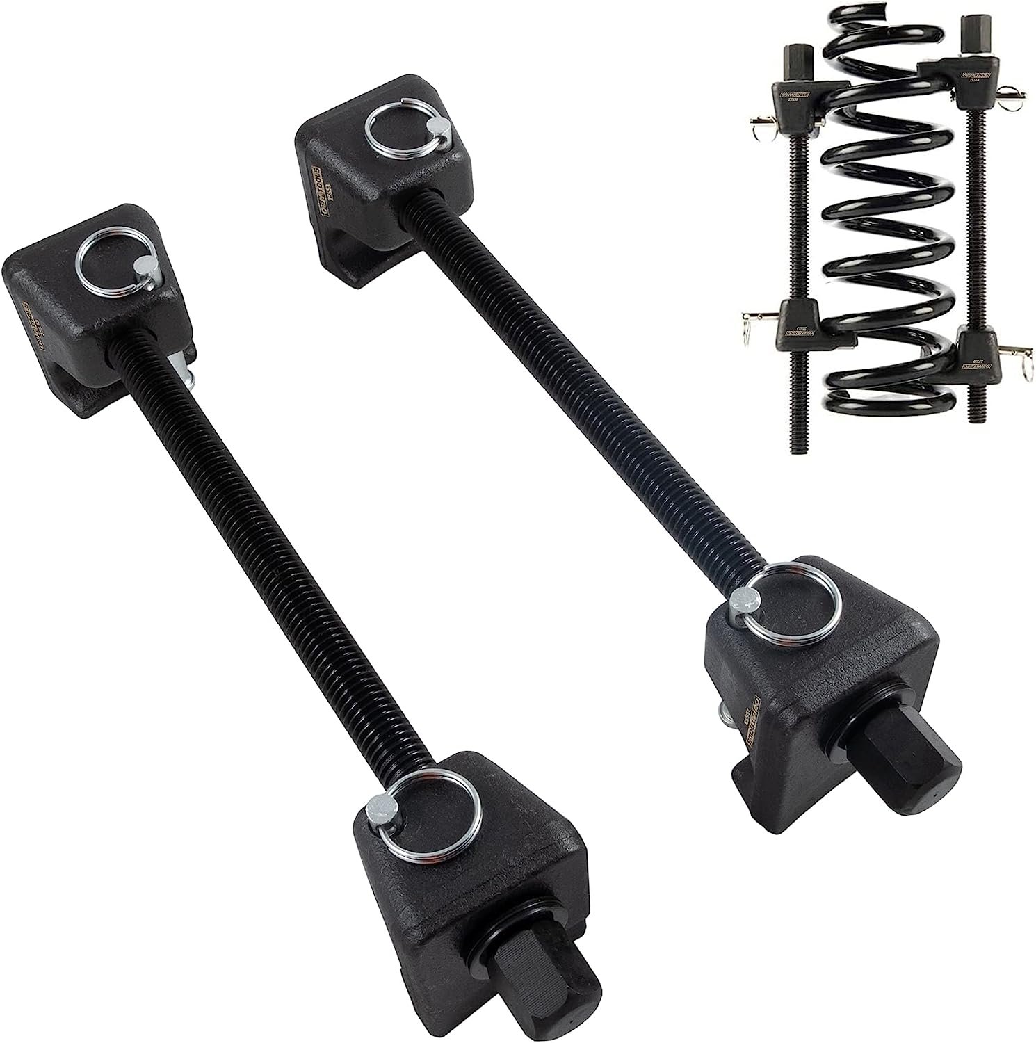

    Yeah Ive taken my 5lug springs out/in half doz times...
    I had to use the oemtool ones inverted upside down, opposite of this picture...
    and I had to use bushing spacers, 2 on ea side to get it to squeeze and clear while compressing, definitely a ballet act...
    I had to put the bushings in-between the crankdown nut and that first floating clamp with big washers in order for it to hang down enough to crank it and it squeeze enough so everything clears...

    had to take the jaws off, spin into the spring, and then spin in the screws, spacers, washers while holding the upper and lower jaws in place.
    takes several tries to get the alignment right....
    the key to it is getting the screw,,,spacer tubes,,,,upside down in a stack under the bottom floating jaw....otherwise as you clamp, the nuts run into the arm preventing you from squeezing further/enough....
    those tubes/spacers I had left over from a ceiling fan spacer install kit....

    those spacers and washers go here....to push the bottom floating grab jaw up enough to clear/work the rachet

    they sell that clamp everywhere...auto zone, harbor freight, ect...
    whether they have it in stock is the tough part...
    autozone stopped using these on the loan-a-tool few years ago.
    but they sell they own brand....and the oemtool one...
    Amazon.com: OEMTOOLS 25553 MacPherson Strut Spring Compressor, Heat-Treated Thread Rod Strut Compressors, Coil Spring Compressor w/ Forged Hooks, 9" Threaded Length , Black : Automotive
    Duralast Strut Spring Compressor (autozone.com)
    OEMTOOLS Macpherson Strut Spring Compressor (autozone.com)
    Hover over image to zoom OEMTOOLS Macpherson Strut Spring Compressor - Search (bing.com)
    they look pretty scary but with that safety pin, no big deal, just take your time...
    make sure they are as close to 180 to each other as possible....if it slips, just redo.

    I believe that lean is supposed to be there. Whenever the driver's weight is on the LH side, it balances it out. If you put in a spacer, you will be trading the lean when its parked for a lean when its being driven.

    His left side is already lower. That's what he's trying to fix.

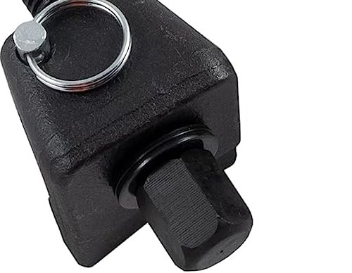

    Here's the pics of that sketchy setup......
    These 5lugs are really small springs, much like a sedan, so you have to use the small compresser's
    Auto garage's will be too large a lot of times....and not work well around our upper control arm setup...
    As you can see, I had to think thru the looking glass, to make it work...
    Make sure you grease those threads.......or you could have a disaster!
    If you dont use those spacers, not only doesnt the racket fit from the bottom,.....
    ......the screw shafts will run into the tophat.....before it fully compress's.
    like I said.....small springs.....and a super tight working space....
