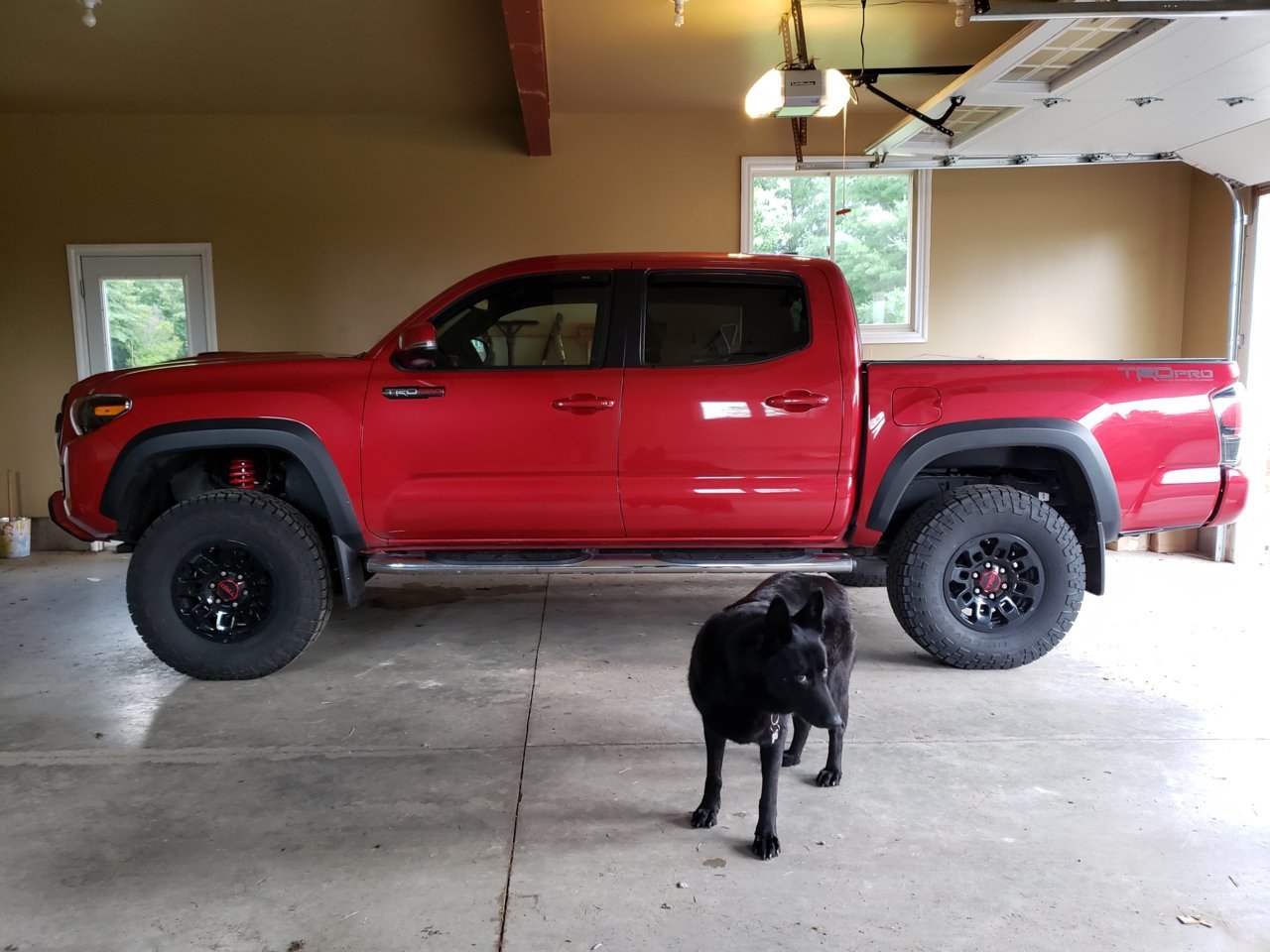

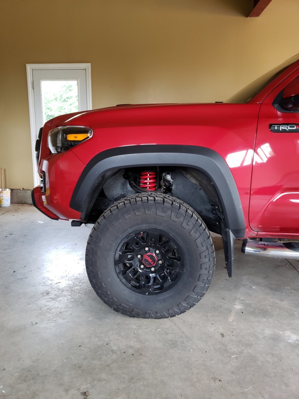

    Bought and installed these last week. Replaced broken/rotted stock Pro coils, reused Fox shocks.
    Toytec had them to me in Canada in less than 24 hours.
    First impressions are it looks pretty cool and the ride quality is decidedly less mannerly than the stock set up was.

    So it was a total fail? Or turned out good? I’m confused

    Not a fail for sure, I'll prob get used to it. But for people that don't use their trucks offroad, definitely something to consider.

    Is it soft or hard? Bouncy or dampened? Body roll?

    I imagine that it's gonna be extra stiff. The coils are far stiffer than stock and at that height (Toytec says 2-2.5" of lift) you're likely taking the Fox shocks out of their proper rebound zone for driving.
    Since OP didn't provide a link I'm just guessing that these are the springs he installed: Are you planning to lift the rear as well or are you going for the front rake look?

    With 700lb coils and no weight up front I’m betting it pretty stiff.

    would it be possible to measure your height? Bottom of fender to center of hub?

    I bet it is. Mine is.
    Toytec springs are all 700lb I learned after getting mine and its was stiff. I needs some weight.

    Hey Troy, how do you like the setup then? Too stiff?

    Yes, for me they are. I don't have any issue off road when aired down, street driving is way too stiff with no added weight on those 700lb springs. I will be changing them out at some point.
