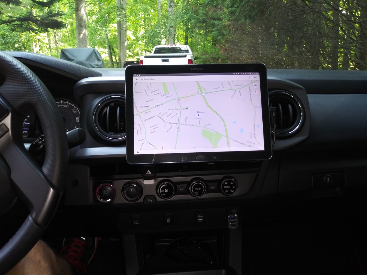

    Entune just wasn't serving my purposes but I didn't want to go to the trouble and expense of installing a new head unit. I had purchased a Samsung Galaxy Note Pro 12.2 (the greatest Android tablet ever made) off of eBay a few years ago and thought I would see how well it would work as my radio interface. The answer is surprising well. The dash is designed in a way that a few simple strips of velcro will hold the tablet securely. I've had the tablet velcroed to my dash for almost a year now and it has never moved. In fact, the velcro holds it so well it is rather difficult to remove from the dash. I was worried about the tablet pressing the buttons on the radio but there is just enough clearance.
    On the radio I have my phone set up as the bluetooth phone device and the tablet as the bluetooth music device and if I get or make a phone call the tablet will mute while the phone is in use. The only downside I've encountered so far is that occasionally I will have to go back and set up the phone as the bluetooth phone device again. Normally I use Apple Music since it is free with my Verizon account, and the display in the dash shows the song names and all the steering wheel controls function to control playback. If I'm using google maps the music will mute when there are voice prompts.
    For charging the tablet I got this off of Amazon. The first one lasted about 10 months and died so I'm on the second one.
    https://www.amazon.com/gp/product/B00U2DGJD2/ref=ppx_yo_dt_b_asin_title_o03_s00?ie=UTF8&psc=1
    For power I tied it into power feeding the radio, drilled an out of sight hole in the bottom of the trim piece, and fed the power plug up to the side of the tablet. The power source is hot all the time so the tablet is always fully charged. The tablet is active on Verizon's network so I'm always online. There is a monthly fee to have the tablet on your carrier's network.
    It is nice having such a large display, especially using google maps at night on trips. The radio doesn't sound that great anyway so I don't really notice the sound quality being any worse since everything is through bluetooth. You could run a headphone cable to the aux in port if you wished.
    Overall it serves my purposes well and actually works better than I though it would. The tablet is 5 years old now, way past any updates, and I've already had to repair it twice, so at some point I'm sure it will cease to function. If it does I'll probably look for another cheap used Verizon tablet off of eBay. Just thought I would share my positive experience if anybody else was considering doing this.

    I really appreciate the response and the information you provided. I'm actually familiar with the XDA forum and it has proved to be a valuable resource for not only the Note Pro, but also many other devices that I have had. I've used it to root and install TWRP and custom ROM's mostly with great success, but have also bricked a device beyond recovery. Unfortunately, from what I've read all the root methods discussed on the forum will not work for the 905V Verizon model which is what I have. Since I mainly just use the tablet for google maps and apple music, being stuck at Lollipop is not really an issue so far.
    I've been a big Android fan in the past but the lack of updates is something that really irritates me. While Apple typically provides updates for devices for at least 5 years I've bought Android devices that never received an official update. Even with high end devices from major manufacturers like Samsung you are lucky to get updates for 2 years from the introduction of the device.
