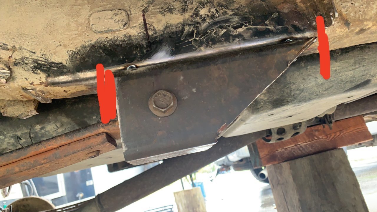

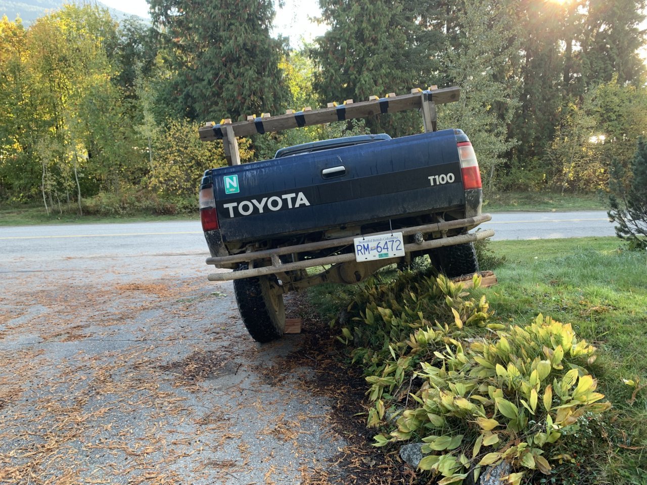

    I got the rear done with 63’s and long travel fox shocks! Ended up being really interesting actually, as the t100’s rear leafs have the exact same center pin to rear eyelet as the 63’s, and were only shorter from front leaf spring eye to the center pin. This allowed me to use the stock rear shackle location and fab up new rear shackles, and only have to cut off and make new front hangers to maintain he wheel perfectly centered in the wheel well. Got some U-bolts from lordco and made flip plates myself. Made new shock mounts and put them up as high as i could while still being under the box. Ended up awesome, flexed like crazy and rode like a dream.

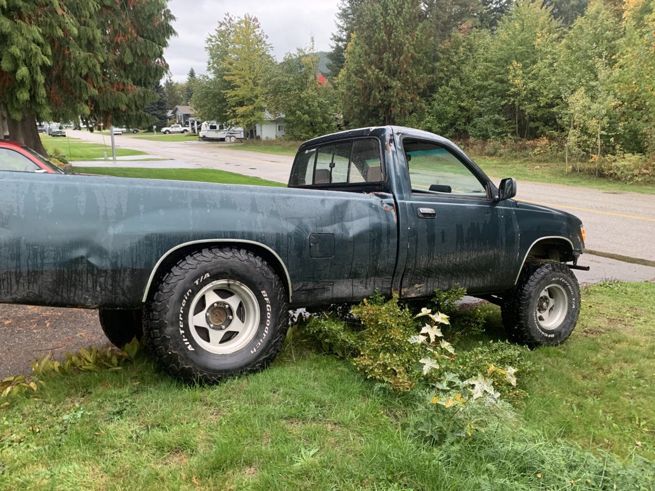

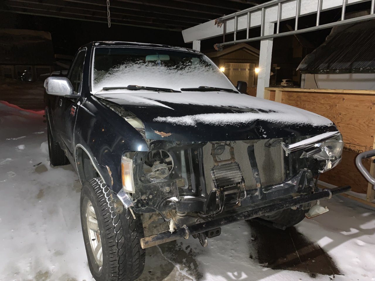

    Very sad ending though, was out rallying before i got the parts to do the front end next and put it in the ditch pretty bad, so the project came to a halt ;(
    Here’s a couple flexing photos, got the wheel pretty tucked but still had so much droop left that i couldn’t show in the photos. Also a photo of the front hangers i made which worked awesome slid well of logs and didn’t get hung up since i made such a long angle. And a photo of it after the crash
