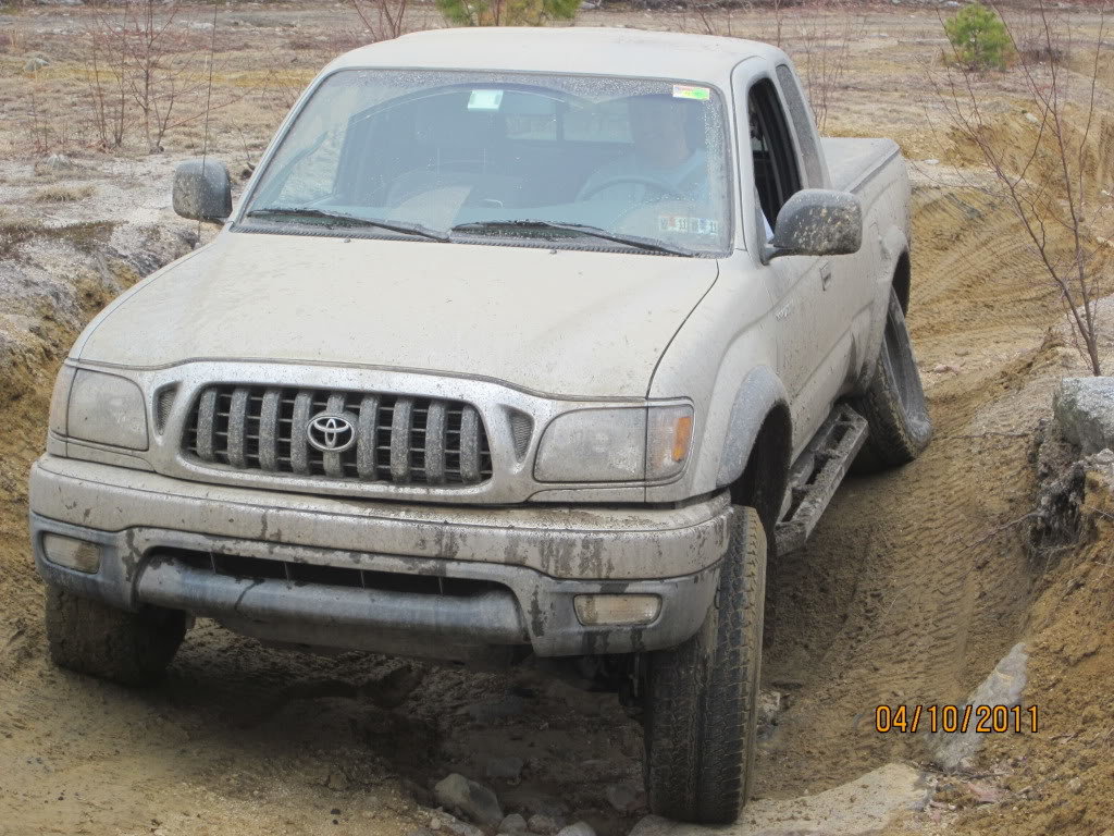

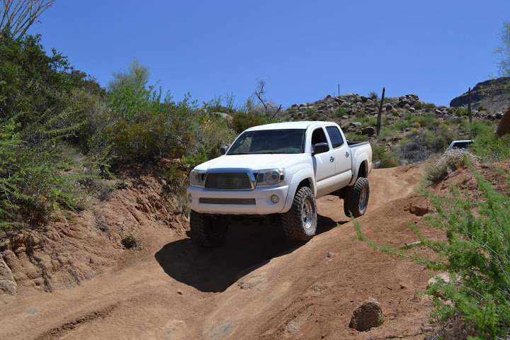

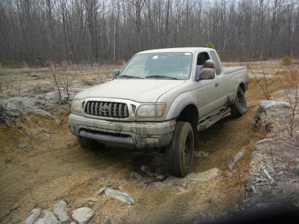

    we should dedicate a picture thread to flexing pics without sway bars

    doesnt really show the front flexing, but better than with it on

    No sway bar.

    Those are some good pics of the potential for ifs. What set up are you running up front? I was also kinda wondering whose sliders those were...pretty sexy...anyway thanks for sharin

    Thanks, up front I just have ICON coilovers cranked to around 2.5" lift. Stock UCAs. The sliders are Demello Offroad Rock Crushers :thumbsup:
