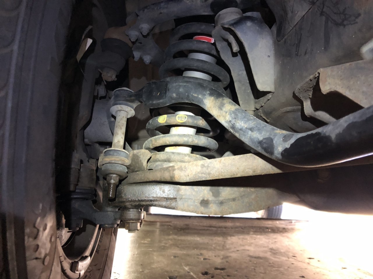

    I'm looking at replacing all my sway bar bushings. The ones on the links look shot. The inner support bushings on the frame I can't tell the condition of. Is this as easy as it looks, jack up the front and pull them all off? Or is there any pressure that will cause something to fly off or be hard to get back on? I'm not going to touch the steering or struts, other than spraying their bushings with silicone.
    The OEM bushings and washers for the sway bar links are available, but the inner bushings (second pic) are discontinued. Is there a good aftermarket kit I should get instead?

    Jun 26, 2014
    #132748
    11,937
