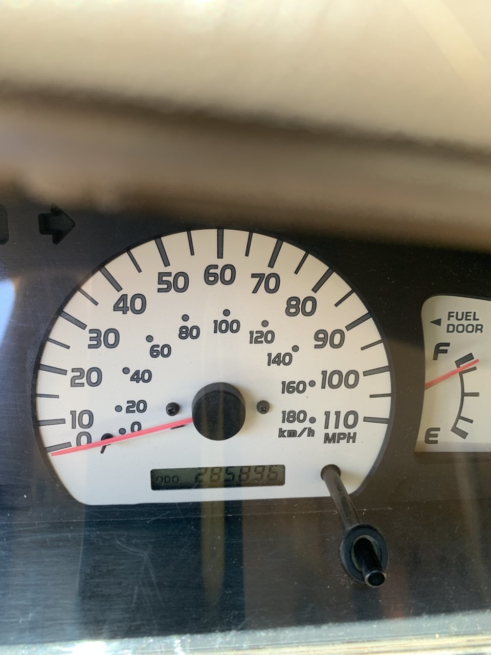

    I recently picked up a white face dash cluster to replace my original black face and knew that the new cluster had 64k less miles than mine. I searched quite a bit about mileage correction and found many threads talking about taking it to the dealer, de-soldiering chips, sending the cluster in to have the mileage reset etc…
    After plugging in the cluster to make sure it worked I started looking at the original to find the e-prom chip I read about swapping and very quickly realized that the odometer is a separate module and takes about 5 minutes to change.
    If this has been posted before I sure couldn’t find it and maybe this helps someone doing this swap. Pics are self explanatory. F92931A3-022E-49B0-8C10-C8228D4FCAA0.jpg183FA193-01E4-4173-8963-DD1940792C04.jpgF8972E88-CF21-45D2-A70E-77573B1389CD.jpg704323A5-5355-49BE-BD17-DD11B55DE294.jpg0474F445-8600-416F-87BD-EEC6C5C3B18D.jpg6433A88D-8BFF-4242-A84B-18C74CE18F17.jpg41AB8814-006C-4979-8A0D-61FE98E34610.jpg

    I recently bought a white faced gauge for my 2000 but my original odometer is the electric/mechanical style. The digital odometer reads 350,000 miles but the original odometer has 245,000 miles. Do you know if the dial type will fit in the same way or is there someone that you can recommend that can correct the digital odometer to read 245,000 miles?

    If you’re original cluster is the black face without tachometer then I doubt the odometer will transfer, but I’ve never had a non-tach cluster apart so maybe?
    As far as changing the mileage on the digital cluster there is probably a way to do it but I could not find any definitive answer to that question.
