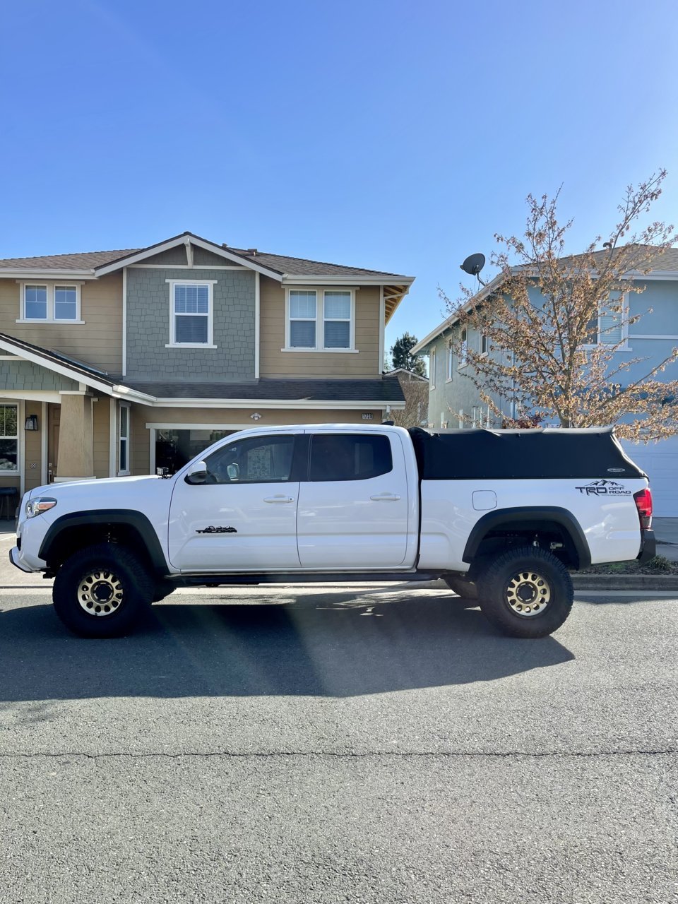

    6112 with 600lb spring at 10/8 with just the TRD aluminum front skid at 22.8” hub to fender front, and 24.75 rear with 275 pounds of topper and bed platform with stage 3 RXTs. Rides smooth like butter and can handle lots of weight out back. Makes my 255/80r17 Falken AT3W look small!4D810066-BB40-426C-8788-CD2515086E9B.jpg

    Looks great!!! Tires look fine

    Thank you! I debated about stage 2 or 3 for the leaf pack and decided to go big once I saw that the front clip 10/8 settings gave a bit more lift than I thought. Glad I went stage 3 in back since its a comfortable ride with just a few hundred pounds and plenty of support when weighted down

    Drove the truck on a moderate trail, Slaughterhouse Gulch near Bailey Colorado, and am stoked on the 6112/5160 combo with RXT springs at stage 3. The truck is much more level and surefooted while rolling over ledges and off of rocks- no more feeling like you’re dropping off the edge of the world like with 5100s or OME. Well worth the extra money over a more basic set up!
