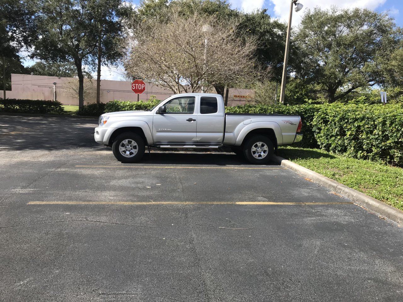

    Ready lift 3” F 2” R

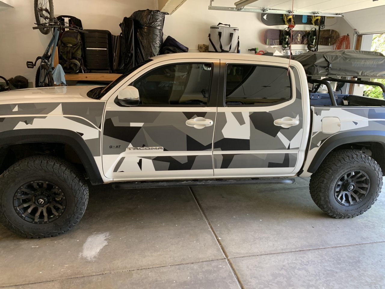

    So far all I did was 1” front spacer which gave me 2” lift and got the 275 KO2 which gave me another inch of clearance, Wheels are fuel d674. Suspension is stock. Weekend off roading and camping anytime possible. 8865BB5E-2581-47C2-A5E4-39B6F4CADDA2.jpg

    How much was ride quality effected with the spacers. That's the exact temporary setup I have in mind unless I can get some 5100s for cheap and use stock springs on them and move the ring a few notches.
