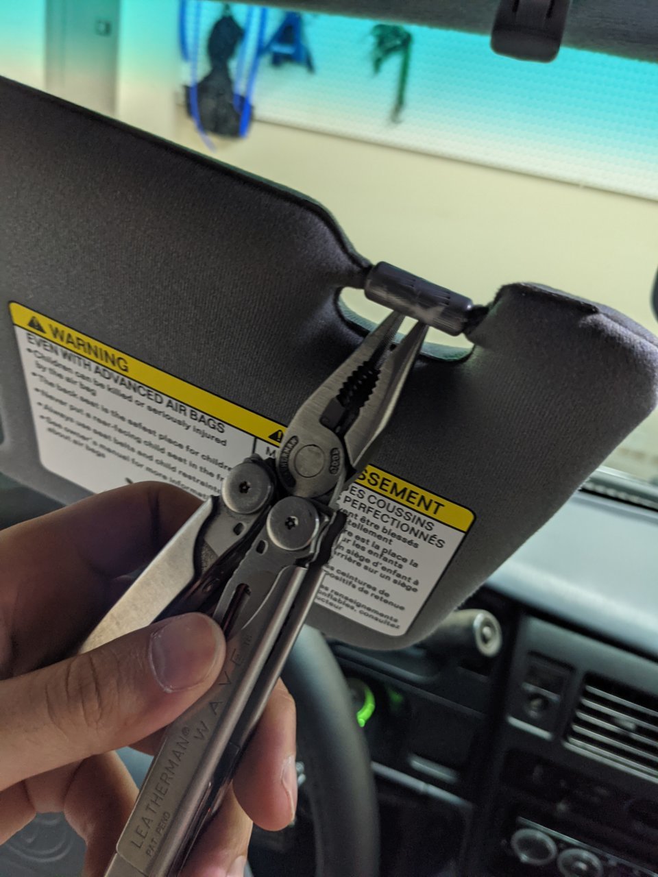

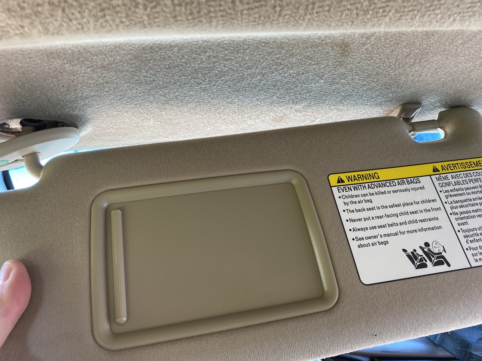

    Just thought I'd update this thread, I went ahead and bought the 2nd gen sin visor and installed it, it's a little tight but it fits, the plastic push in bar had to be squeezed a bit with pliers for it to fit since it's a little bigger than the gen 1 sun visor
    I attached some pics of how it looks

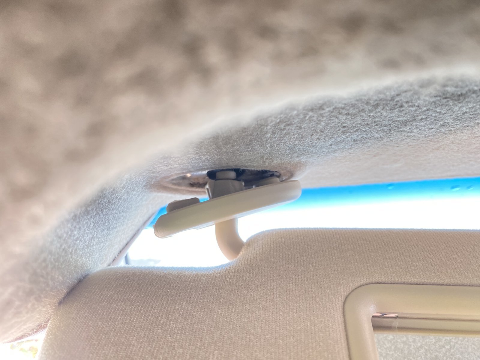

    Not sure why, but the Dasbecan 2nd gen visor does not fit on my 04 extended cab. The angle is wrong and it’s too long to line up with the clasp.

    I just had the same issue with my 99 Taco, didn’t fit. Anyone had any luck with other visors?? Thanks in advance

    Do bolt holes match up?
    If yes, then some gentle bending of that arm needed
  11. Dec 9, 2023 at 3:51 PM
    rluis05
    rluis05 Active Member
    Sep 28, 2016
    #198494
    25
    99 Tacoma SR5 3.4
    They almost do, the middle swivel section is too wide won’t fit through the hole. I’ll keep looking at other vehicles maybe they’ll fit better.

    remember, your (I will too) be adapting a non fit part…..to fit
    what about using washers to make the swivel fit thru hole?
