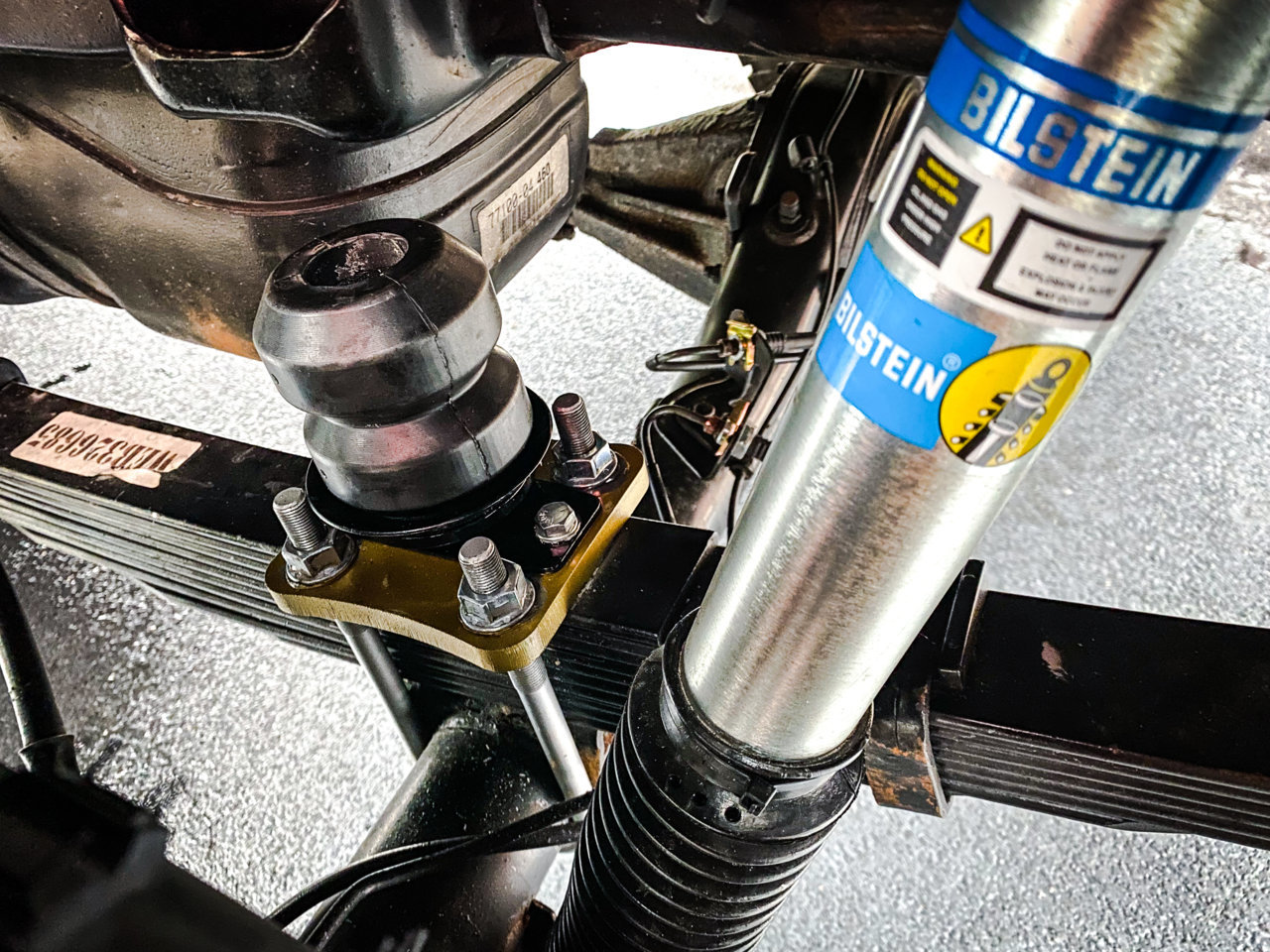

    Timbren SES is designed to be there when you need it so you won't notice a difference when your truck is unloaded. Our rubber composite helper spring is hard enough to keep your truck level when loaded and soft enough to give you a smooth ride when activated. Backed by a lifetime guarantee we stand behind our products, from the ease of installation to virtually no maintenance necessary. Here is the specific setup for your truck - Timbren SES

    i had the sumos for a while and they did what they were designed for, but i tend to run light and that had my rear end literally bucking at highway speed from them preventing compression. after i removed them the top 2" of the sumos were destroyed, wish i had a pic of that. basically the compression of my shocks was nearly never used. that was on me because i never had much in the bed aside from my spare and 80lbs sand in the cold season.
    i changed to the timbrens with a u bolt kit and it's a dream come true for my ride and handling, no more bucking and a nice clean ride with my rear suspension actually working. the timbrens are great, but they won't do much for holding up weight like the sumos.
