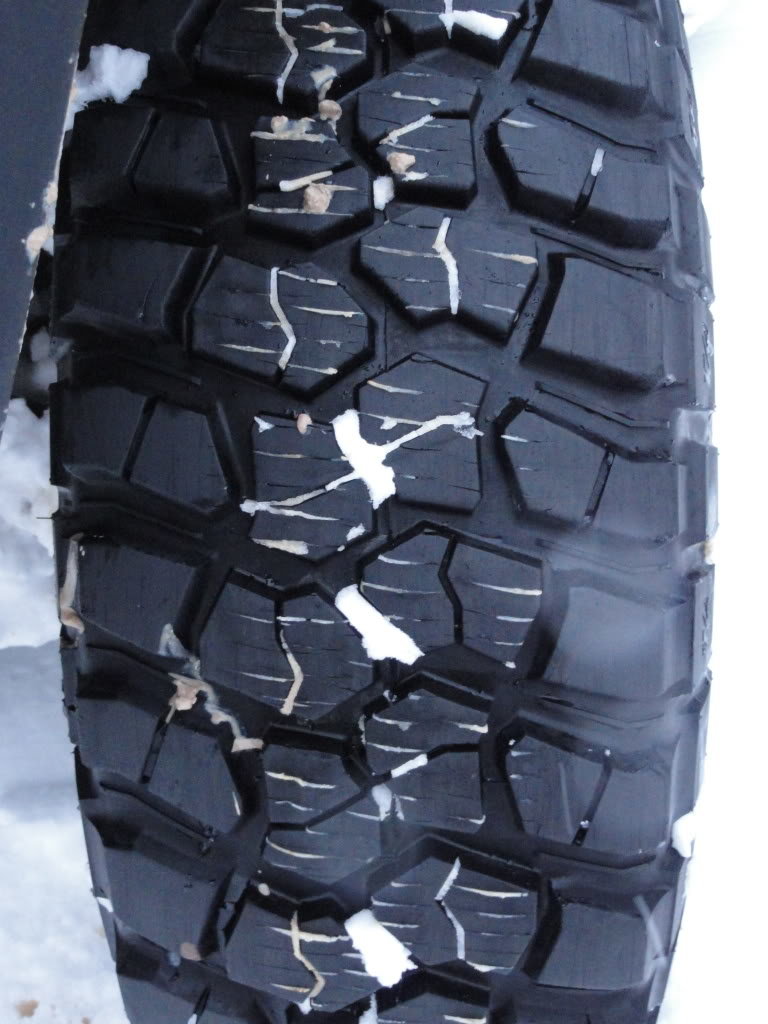

    I got my KM2s done at America's Tire for $20 total. I talked him down from $40 though.

    what does a km2 looked like siped? and the at bfg would be a good choice

    so what does that help do and did he just use a knife?

    It's supposed to aid in traction on snow and ice. The couple times I've had them in snow I didn't have any wheel slippage and I haven't slid at all yet so I'd say so far so good.
    They have some kind of machine that does it.

    I took mine to be siped, and they did the whole tire instead of just the inner lugs. Forgot to say something. Oops!
    Was 25 a tire I believe.
