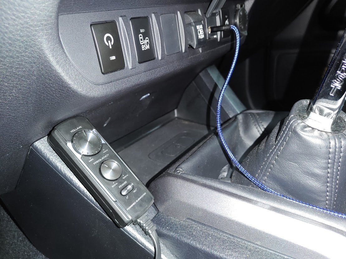

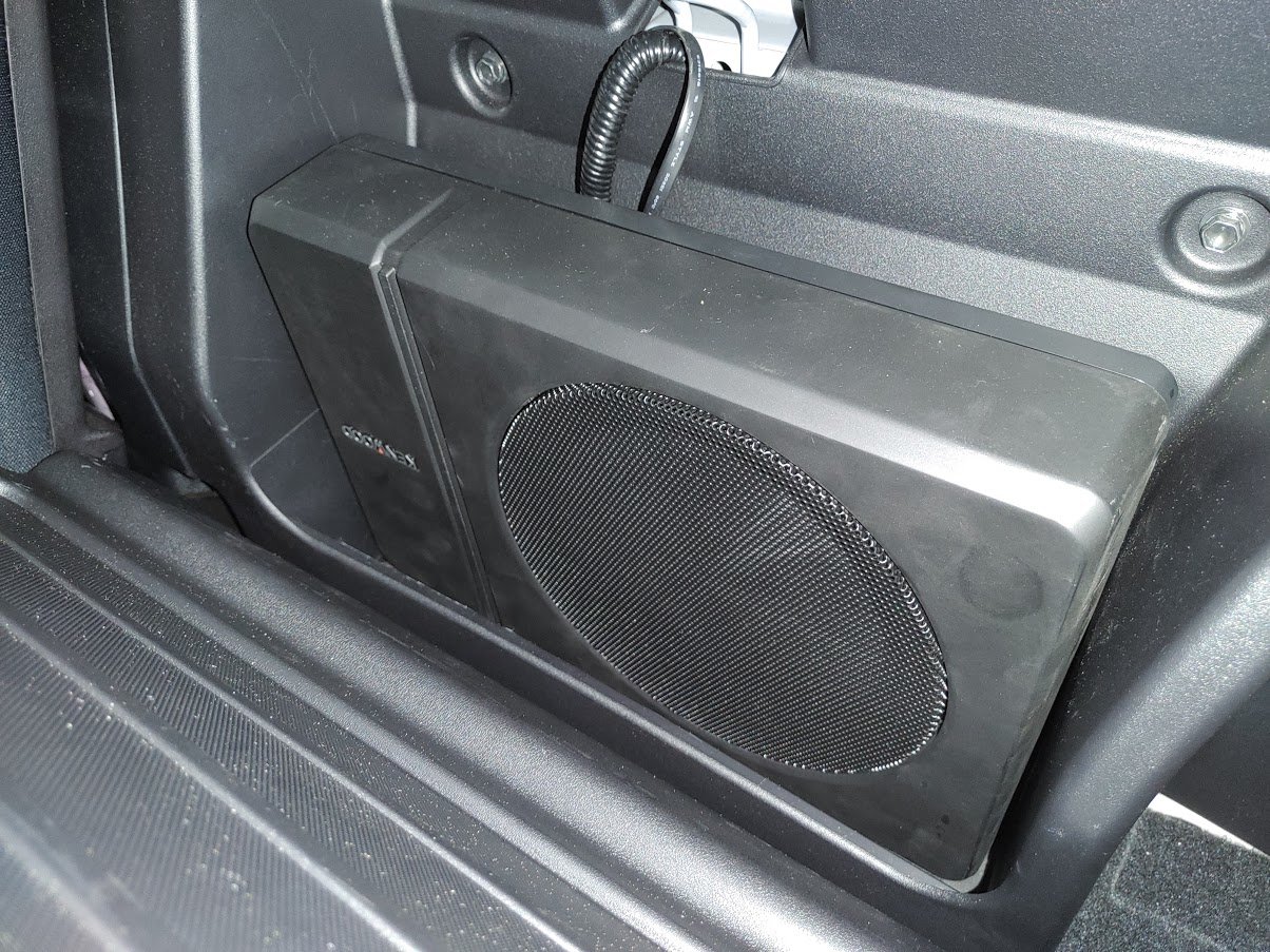

  11. Jan 14, 2021 at 8:26 AM
    mjanmohammad
    mjanmohammad Well-Known Member
    Apr 20, 2018
    #251138
    110
    Moe
    How hard was this to install? Any other parts needed?

    I asssume you're talking about my setup. I don't have any videos or photos, sorry.
    Current setup is:
    Alpine KTP-445U Universal Power Pack class-D amp behind factory headhead unit
    JLAudio C1-690 6×9″ 2-way (fronts)
    JLAudio C1-650x 6.5″ 2-way (rears)
    Kenwood KSC-PSW8 powered sub.
    As for the install process it's pretty standard, there are a few how-to's available here and on Youtube.

    The rears don't sound as clear as the fronts, I think the headunit's sound processor muffles the sound a little bit in the rear.
    And only reason I chose Alpine over Kicker amp is price and availability (I'm in Canada). It doesn't have a built-in sound processor like Kicker but rest of specs are similar.
    Overall I like my setup, highs are loud and clear and there's enough bass to shake the mirrors. I cut all bass in fronts (amp's high pass crossover) so there's minimum distortion at high volume. The rears and sub cover the mid/low bass and I can adjust bass on the fly depending on the music I'm listening.
