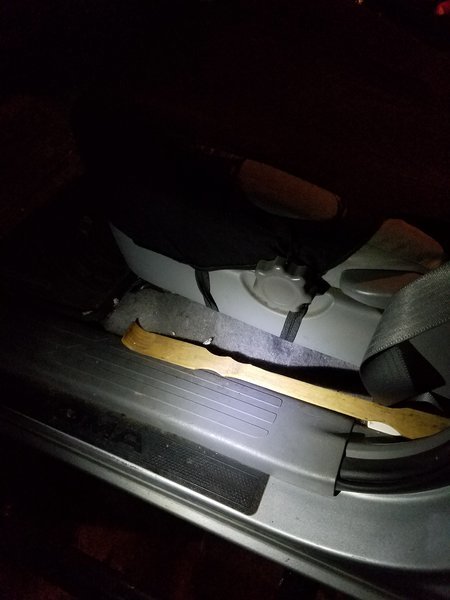

    Back scratcher

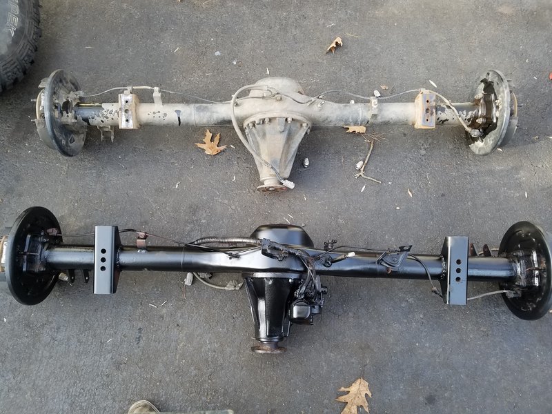

    E locker full rear axle swap, heavy duty spring perches

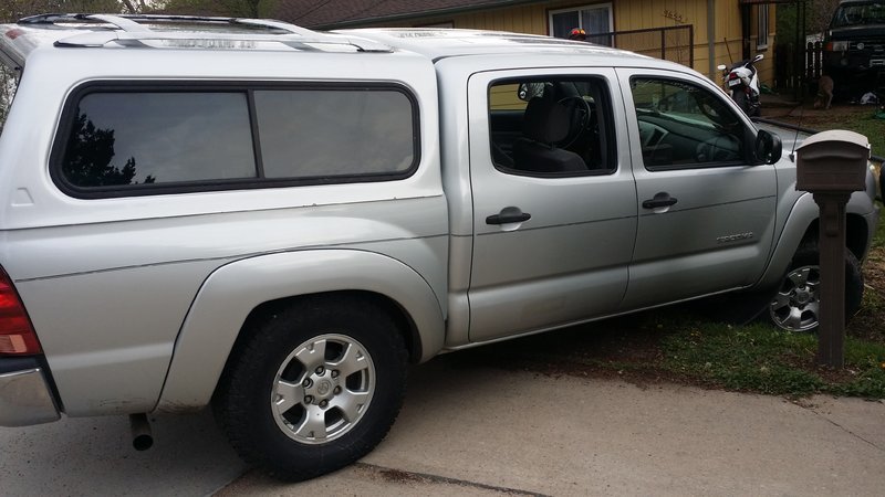

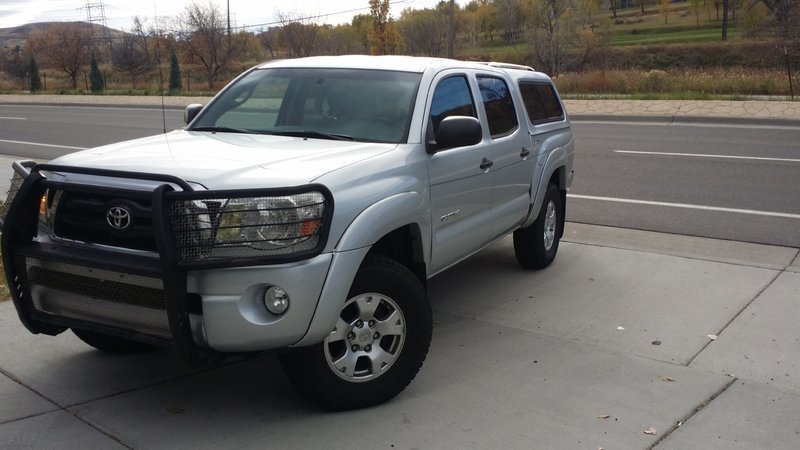

    Photo of day I got it:

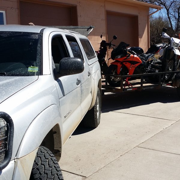

    First decent sized haul (when i was a motorcycle mechanic):

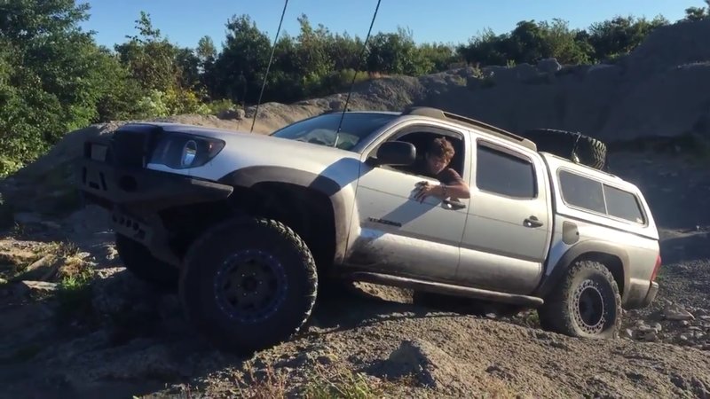

    Front yard flexing:
    Kept the truck like this for the better part of a year and a half. A few mods here and there (rubber floor mats and seat covers, in channel vent shades). At some point I added the back scratcher mod.

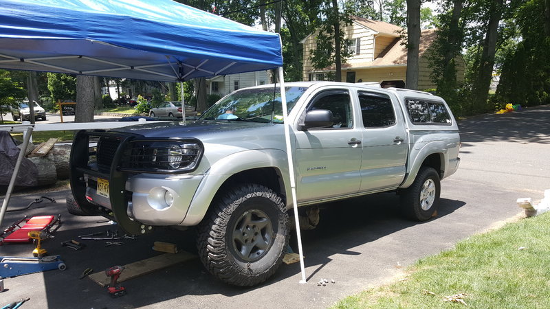

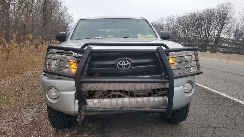

    Fast forward to spring 2016, I have moved back to Jersey. I got the leaf spring recall done and the frame coated. I have been searching for trails and ppl to ride with and decide I need to lift the truck to get over moar rocks. I went on a few wheeling trips by my new place and started really thinking about Modding the truck:

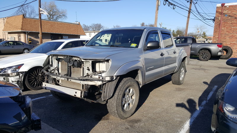

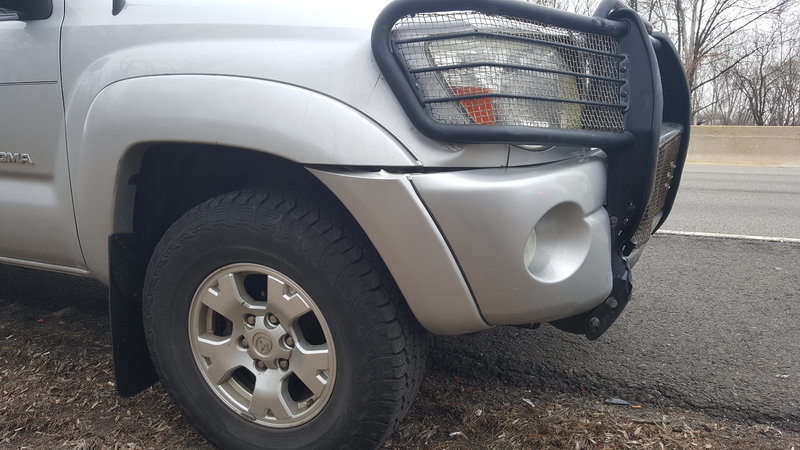

    Then, I rear end a beamer on the parkway and the front end got a makeover. I had already been thinking about new lights and grill:
    So while searching for parts I remembered my tw account and began reading and searching tw for advice and products.
    Here's where I started losing my mind.
    So I got a new grill, new brush guard, and new lights with halos paid for by my deductible. I also installed a led brake light strip with reverse under tailgate, throws a lot of light. Installed bed lights as well (pictured later with shovel and axe mount):
    I then notice the ome group buy and order the light kit with 885s, 90021s, and Dakar leaf packs. Still wasn't planning on anything crazy, hence the 885s.

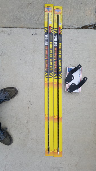

    Installed dual cb antennas, radio, and pa.

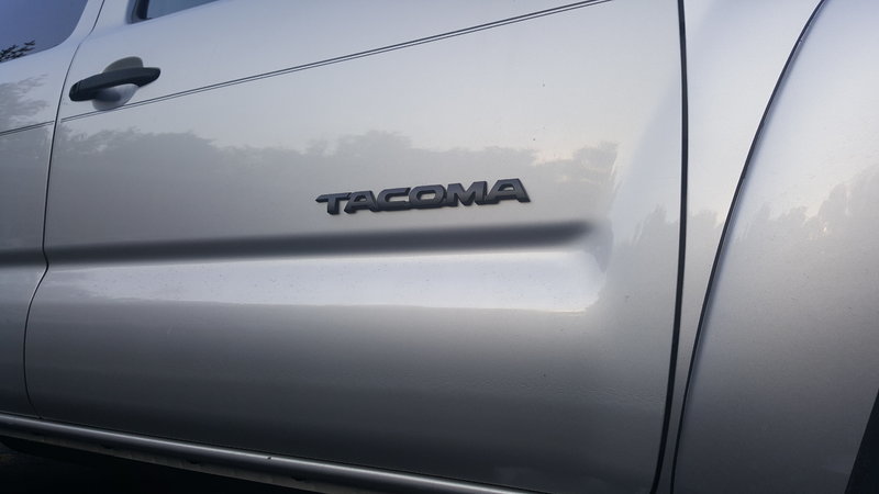

    Plasti dipped emblems

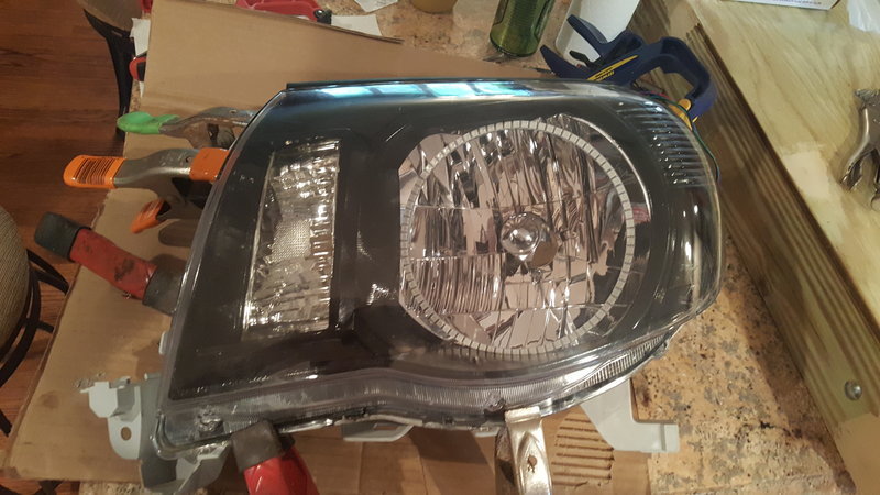

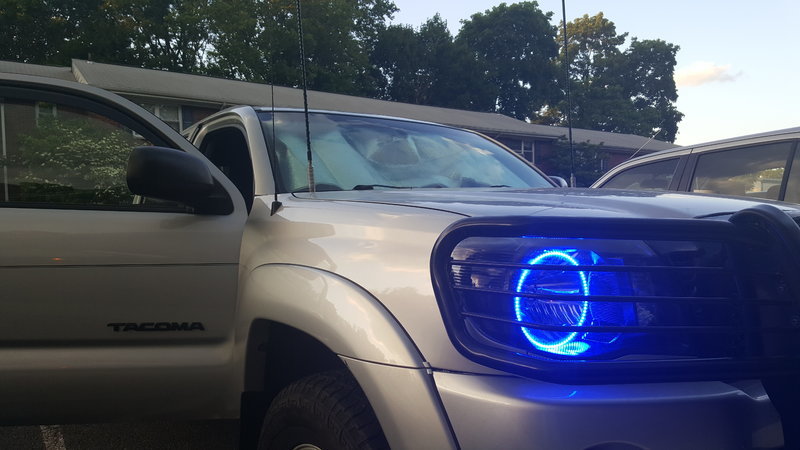

    Black headlight mod:

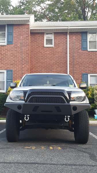

    Made a ridiculous impulse buy on front bump. Dad took the brush guard.

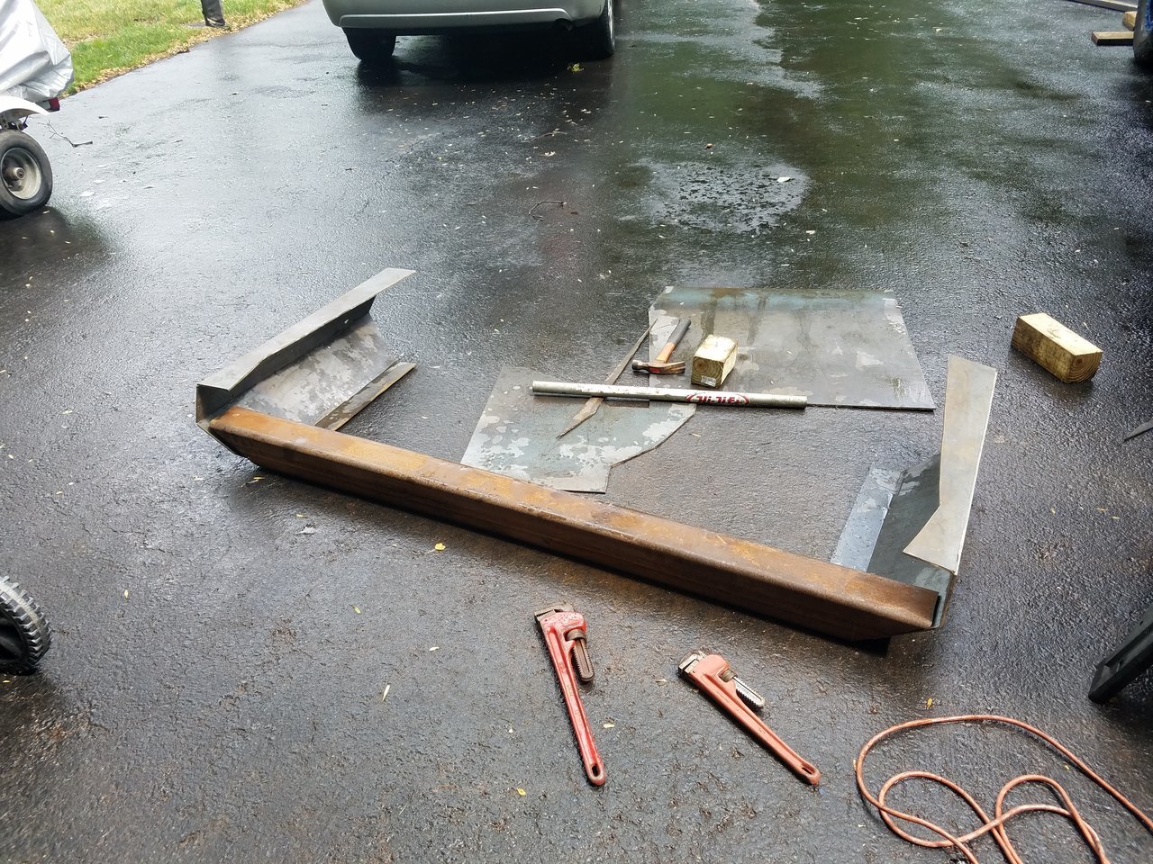

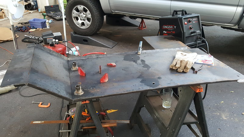

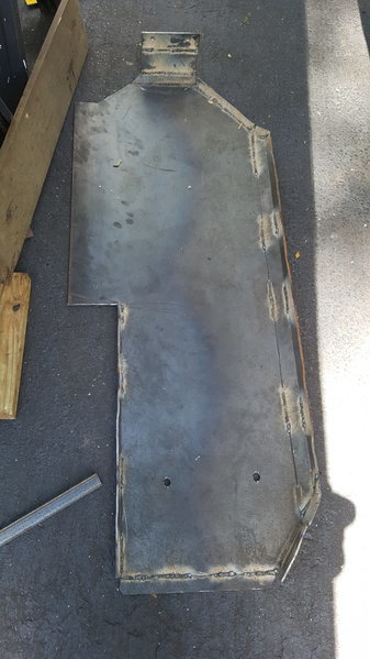

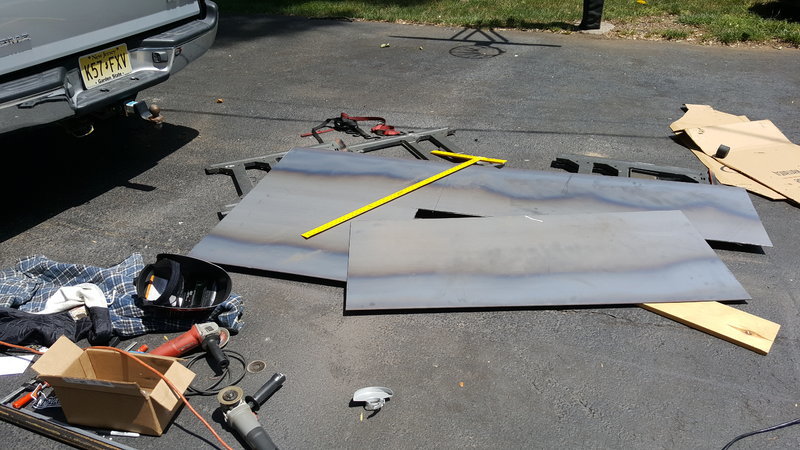

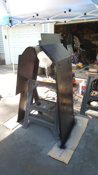

    With Rausch creek takeover quickly approaching, I decided to make a set of skid plates. I used 3/16" steel with 1x1x1/8" angle iron reinforcement. Bends made with an angle grinder and pipe wrench, then I welded the seams (my first real attempts at welding).
    Also made fire extinguisher, shovel, and axe mounts.

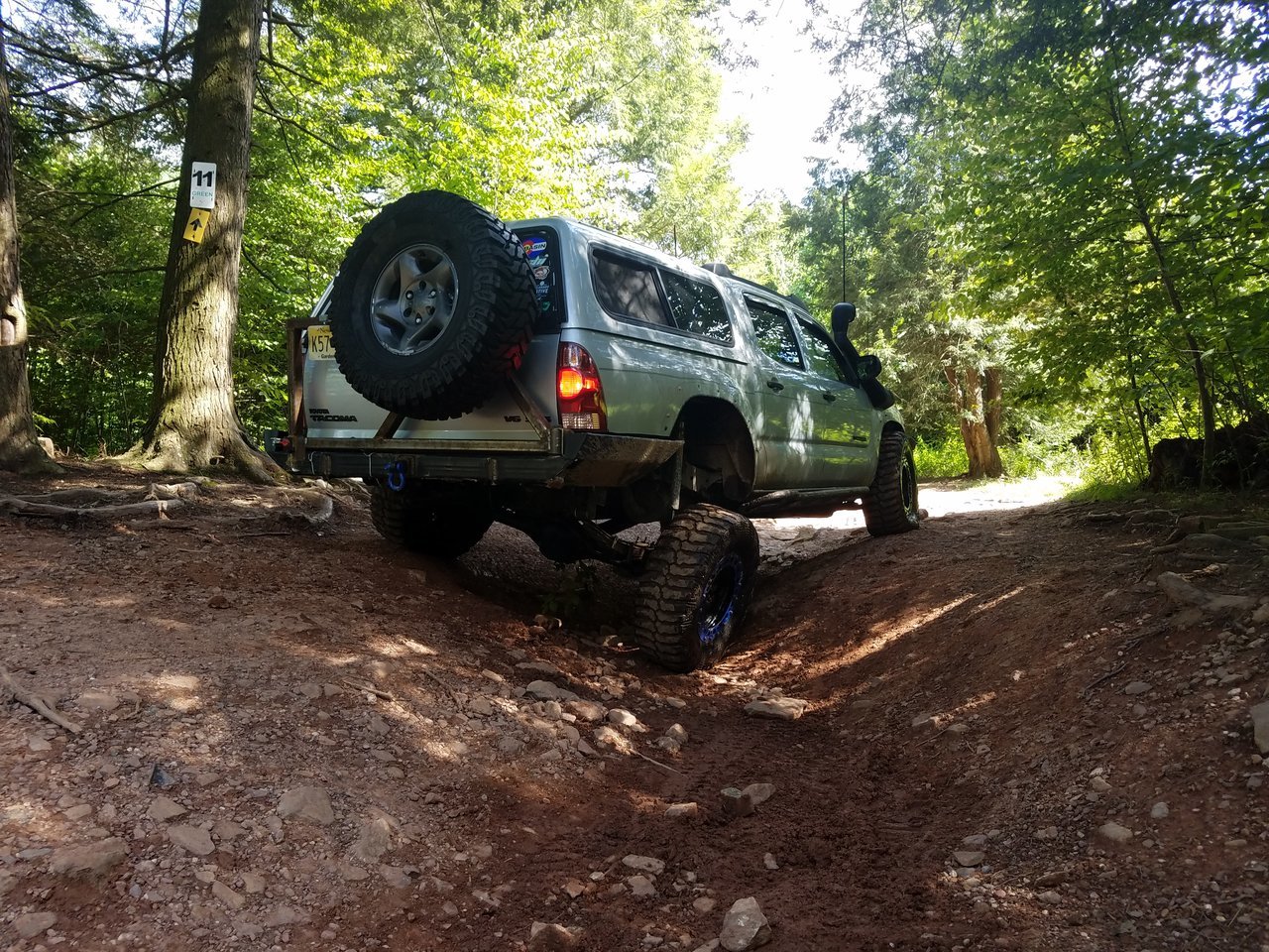

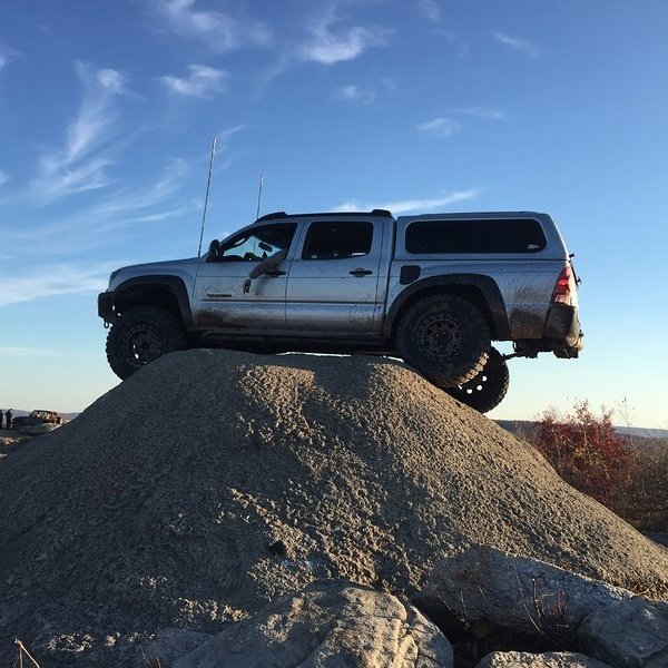

    Then I went to Rausch creek. While there, I relocated my rear diff breather. And scraped the crap outta my new skids (thank god I had em).
    The week after Rausch, I kept with the full idiot trend and found a set of 315/70r17 Dick Cepek Crushers to try and stuff under there.
    My ifs skid is sitting at about 9" off the ground. With 886s and 35s I'm hoping for at least 12" to the skid. That's enough for now, sorry for the long post. I'm sure I'll edit this as I remember more mods I've done.

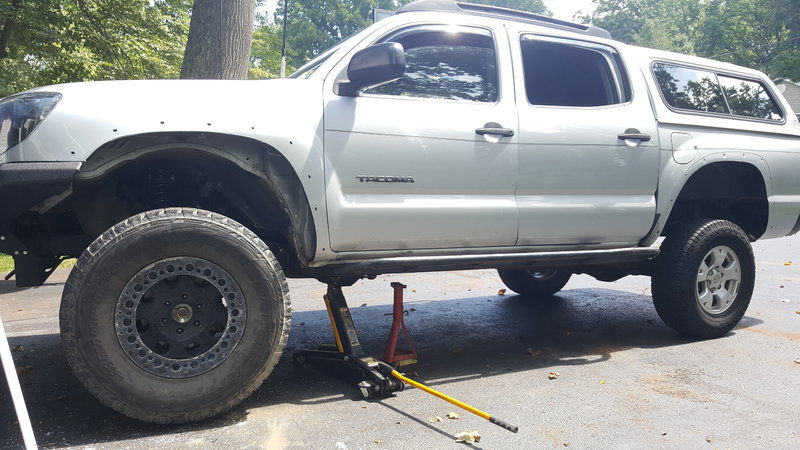

    Finished making room for 35s...
    this weekend should be fun.

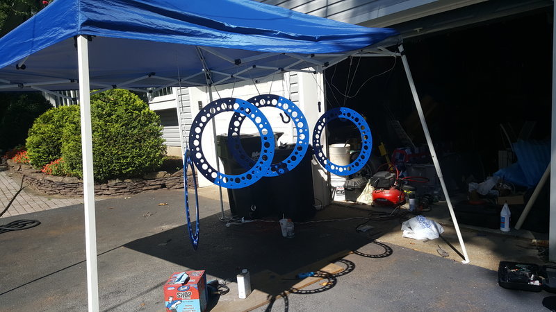

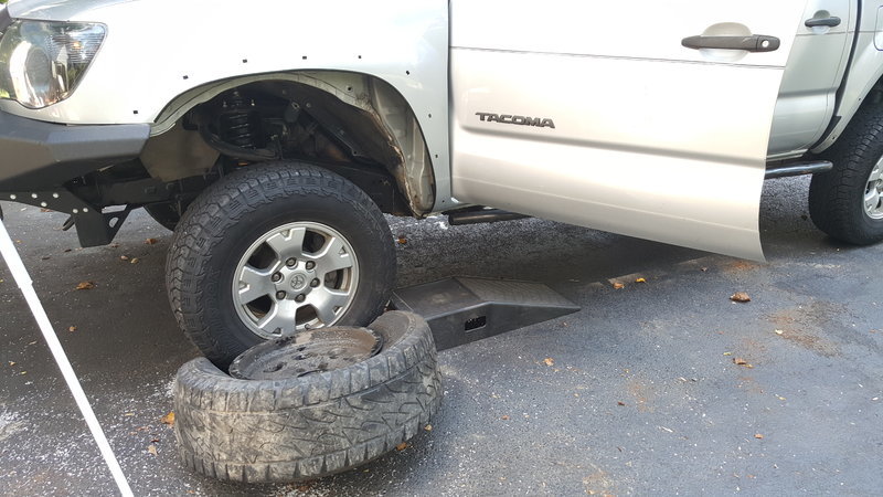

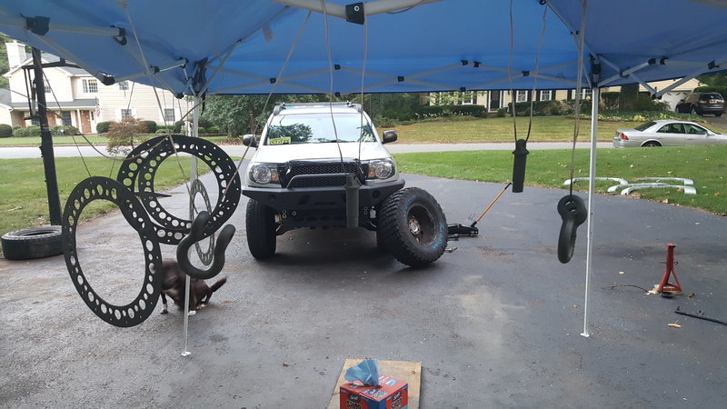

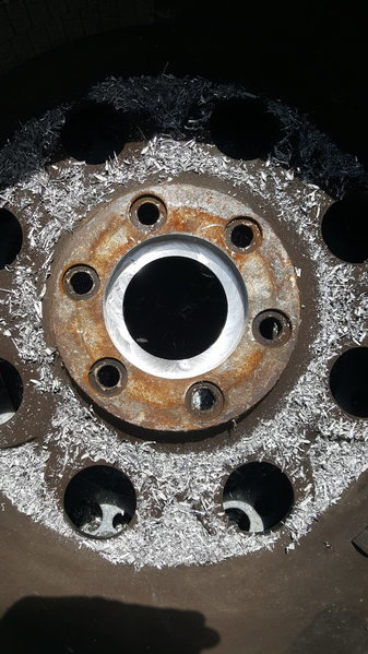

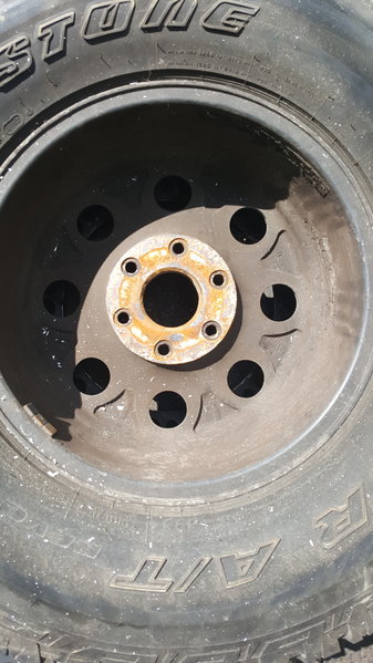

    This weekend got the tires mounted on the new wheels. I tried to dismount and mount the new tires myself but I new it was a losing battle. Used my truck to break the beads, that's as far as I got.
    Then I had sears do the rest. I had to bore out the wheels with a Router because they were the wrong size, hopefully that works out well. They seem to fit great and look like they were done on a CNC.
    I also cleaned them up and painted the bead lock rings and d rings. Then I sprayed all the wheel wells with matte black paint to help it blend in better. I think it looks much better.

    Had to remove 1.25" spacers because they caused bad rub on cab mount. Doesn't seem to rub ucas and frame much if at all without spacers so I may be ok. If anything, I think 1/2" spacer will do the trick. There will be more cmc in the future tho.
    Baby test flex after removing spacers

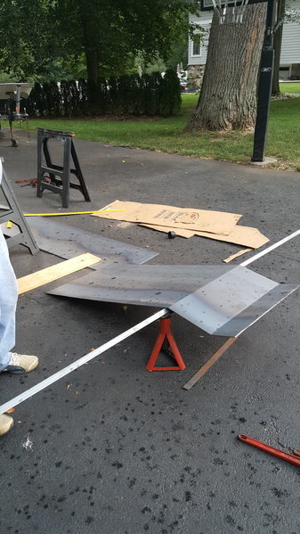

    Flares are cut and plastidipped, also realized my exhaust dented my bedside, so I chopped the exhaust to dump after the axle in the parking lot at Rausch, thanks Tim for the grinder.

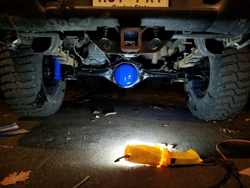

    Got the e locker axle welded up, cleaned up, new brakes, and got it installed with full oem wiring woohoo!

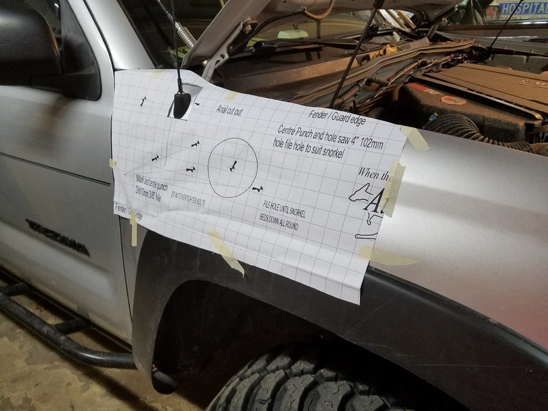

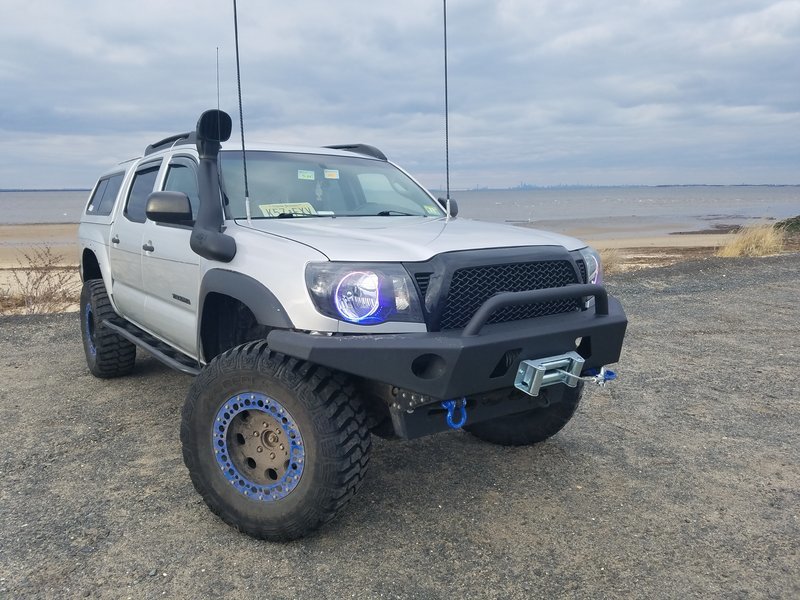

    Finally got the airflow snorkel from group buy...installed that night...earlier in the week I installed the smittybuilt x20 12k winch with wireless remote

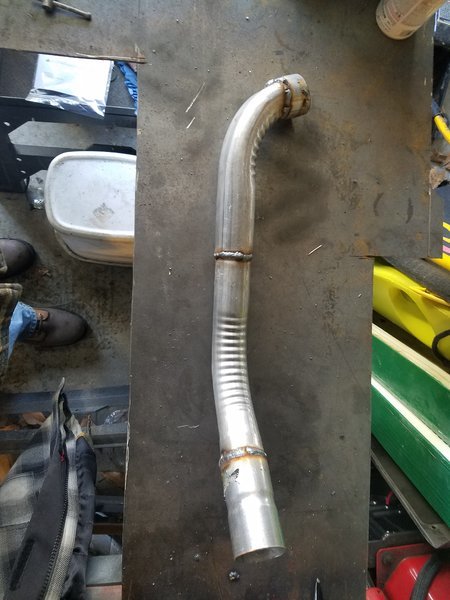

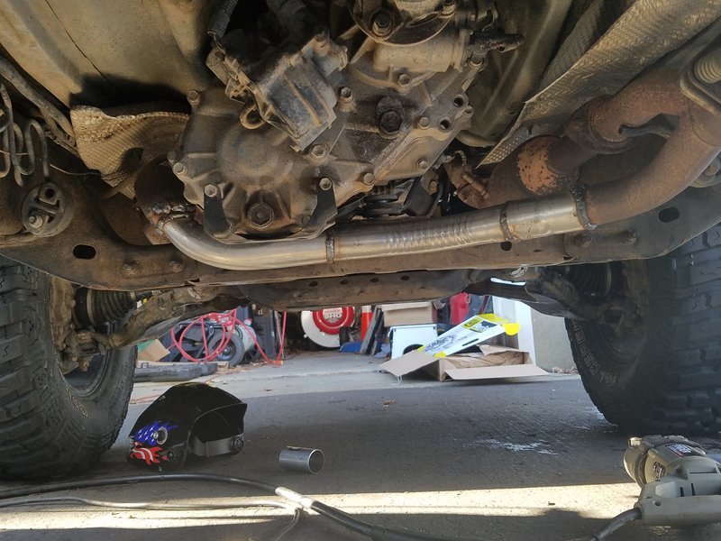

    Did an exhaust reroute so I can have flat belly skids....Idk why more ppl don't do it this way, pretty simple

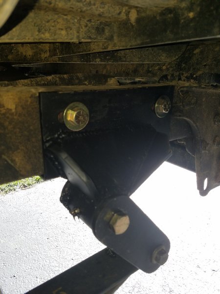

    Also last week @stairgod and i made a shackle flip, still gotta install it.
    4/7/17

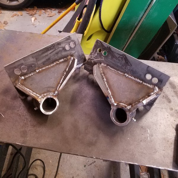

    Got my shackle flip on. Custom made by Jon and I. Came out great! The extended travel shocks, towers, and add a leaf are on their way to my house! Thanks @stairgod for all your help!
    4/30/17
    Made a u bolt flip, added a leaf to my Dakars, and added 14" bilsteins with f250 shock towers, both shocks in front of axle and lower shock mounts in line with bottom of axle tube. The Dakars limit travel up and down now....about 12" of travel

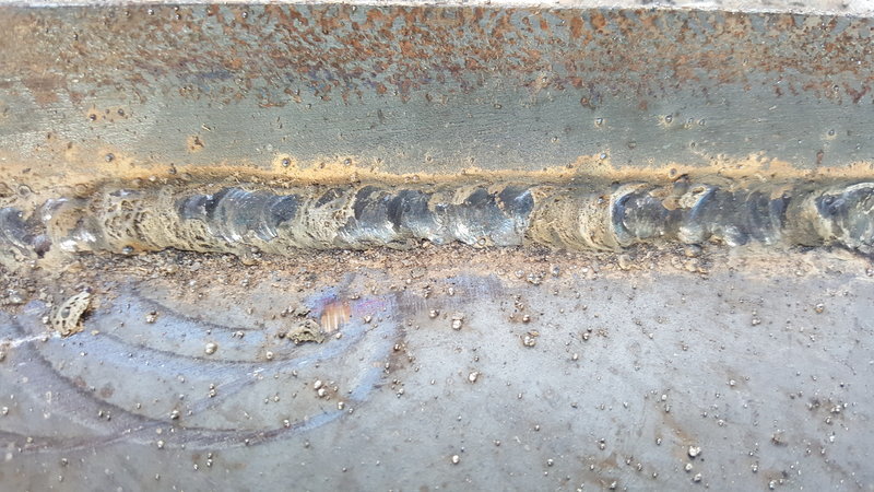

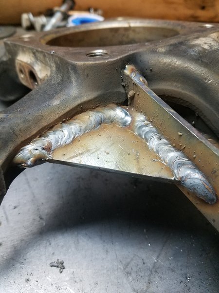

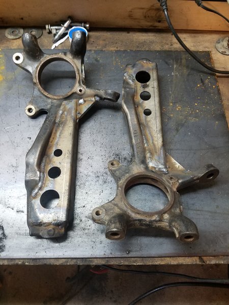

    Weldedup spindles today and added steering gusset

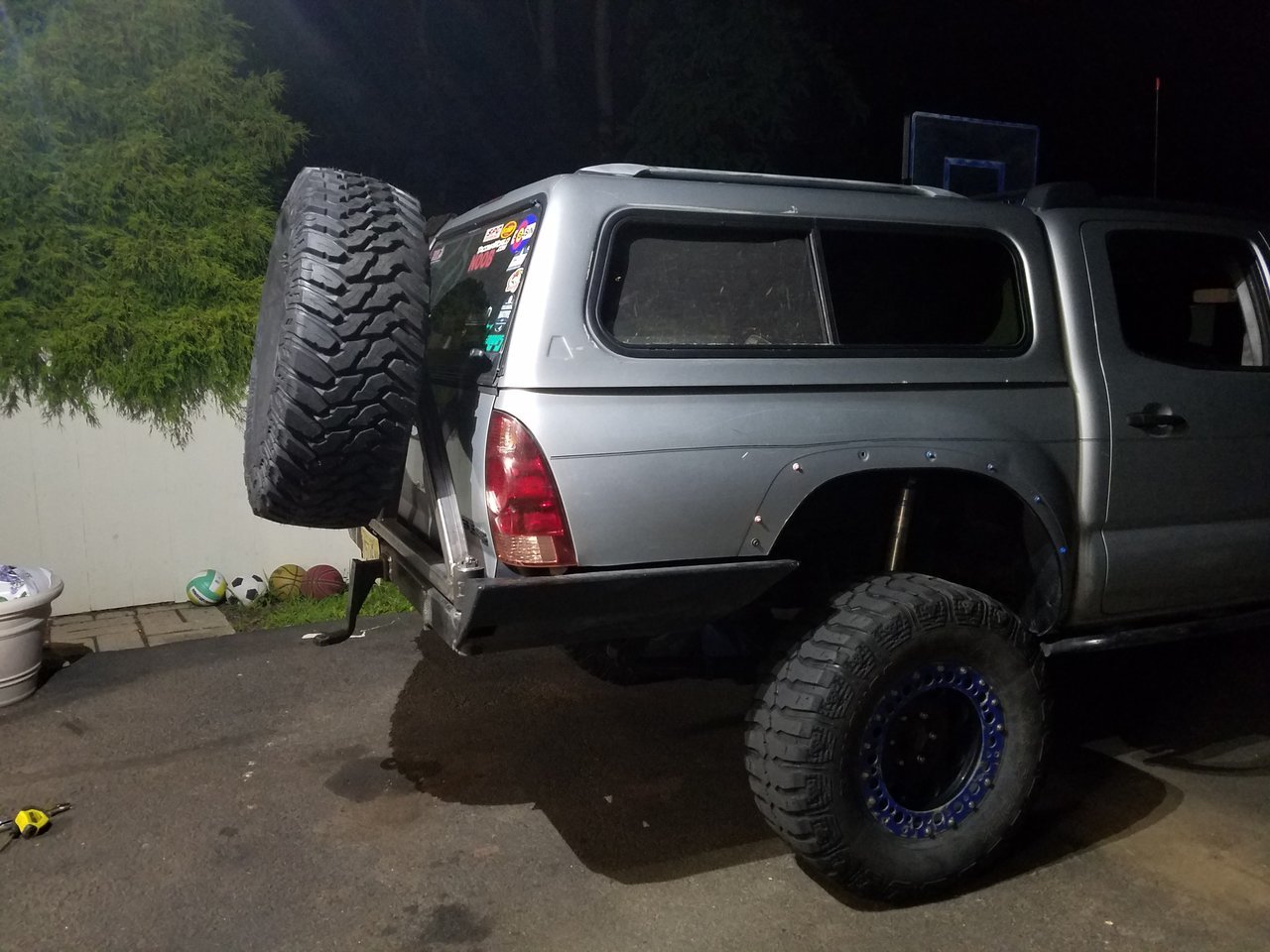

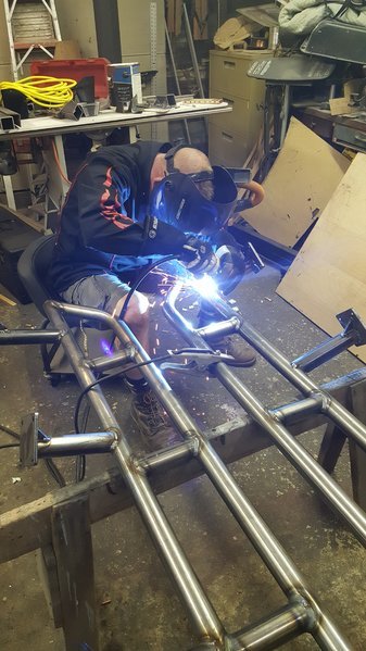

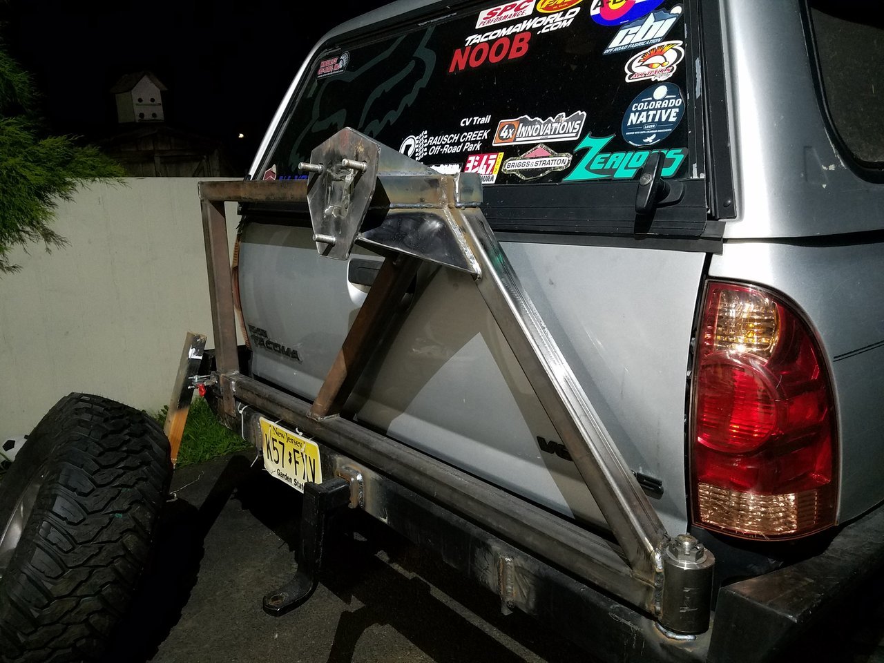

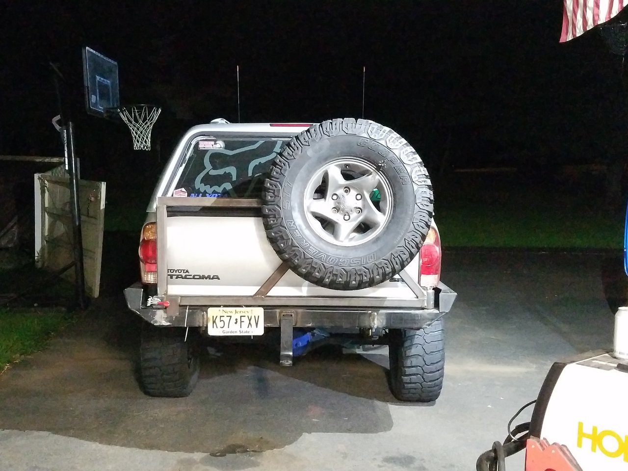

    Started work on the high clearance rear with swing out

    Helps seal the fender to keep out rust and keeps the trim on
