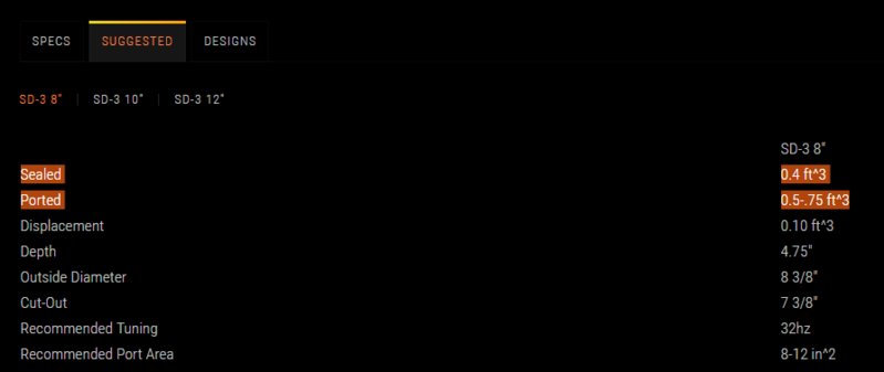

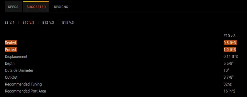

    So i actually called sundown to talk to them about their subs. The EV3 series subs are made for ported boxes (Per the guy at sundown). He said that they dont sound that good in a sealed box. He did recommend the SD3 series. ..
    The SD3 series is good for sealed and ported boxes. The SD3 has the inverted surround so there in more excursion "in" rather than "out". The SD3 requires .4 square feet (ft^3) of air space for a sealed box and .5-.75^3 for a ported box.
    The EV3 series requires more and likes ported boxes.... .5 for a sealed and 1 for a ported box.
    Another think to consider is the mount depth... you may build a box that does not fit the subs...
    Also the EV3 subs have air holes in the motor and require space at the rear of the sub to allow air to escape. The SD3 does NOT have any holes in the motor so you do not have to worry about that.
    I think that with the SD3s you will be able to build a shorter bottom box that will allow more room for excursion and you can definatly get 3 in the back of your tacoma.

    Since asking this question I've done more research and I think I am going to go with two SD3 12's in a sealed enclosure. oh and BTW you are compare 8" sd3 specs to 10" EV3 specs. the sd3 and EV3 require about the same airspace except that the ev3 needs space behind the magnet and the sd3 does not. I've personally heard the E series and they were never in consideration for my usage. they don't sound very good musically. they're more for somebody who just wants a good amount of bass cheap. The SA's on the other hand Put out a lot of bass AND sound decent. And then you've got the SD's they put out good sounding bass and are loud for their size and airspace requirements but don't compare bass wise to the SA's and the SA's don't compare musically to the SD's and the E's really don't compare to either IMO
