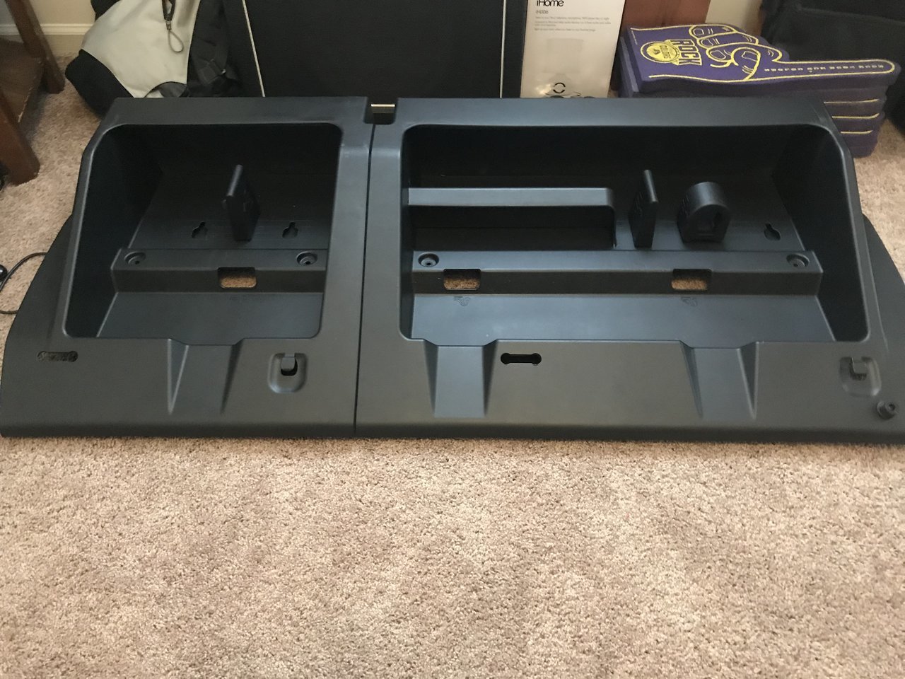

    You’re probably better off taking the plastic storage racks out...I took mine out and I’m still having trouble finding a box that will fit behind my seats. Without the racks, you need a slanted box, bottom depth of 7.5” and top depth of 3.5”...all the ones I’ve seen though have been for 2 10’s or 2 12’s and I’m just looking for 1 10. With the storage racks in you’re looking at a box even smaller than that and I’m just not sure you’re going to find one retail.
    But to get them out it’s just 6 10mm bolts, 3 in each side, and one phillips head screw in passenger side top corner. You need to take both out at same time because they are clipped together. They’ll be a tight fit at first but they’ll come out.

    I built my own 10in single sub box with dimensions someone posted here many moons ago but it will required you to trim most of the plastic out. It looks exactly like the photo above. www.*********.com sells a single 10in/12in single sub box but again, you will need to trim the plastic. The only sub i know what will fit into bin without any trimming are those small dinky sub/amp all in one solutions.

    Custom box? Im looking to do the same thing. Retain at the very least the plastic trim surround and will to cut out the middle. ********* has something similar but requires the removal of the plastic panel behind the seat. Any info would be super helpful.

    I ditched that recently and built my own sub box that fits into the space behind the rear seat. I removed the plastic (no, you don't need to remove both the passenger and driver. They'll unclip separately) and fit a JL 10tw3. There wasn't a nice way to get a 10" with enough internal volume and have the back seats in the UP position. Plus, my backseats are down 99% of the time. Mine fits in the space and is still out of the way for my adventure gear. Since I had more space to play with, I built a ported enclosure. Hits hard is all I can say. Kicker amp under my drivers seat.

    Stock entune system non jbl. Single 8inch ported behind driver side rear seat. Had to pull plastic cubby (rear wall) only. Still a tight fit and it sounds decent.
