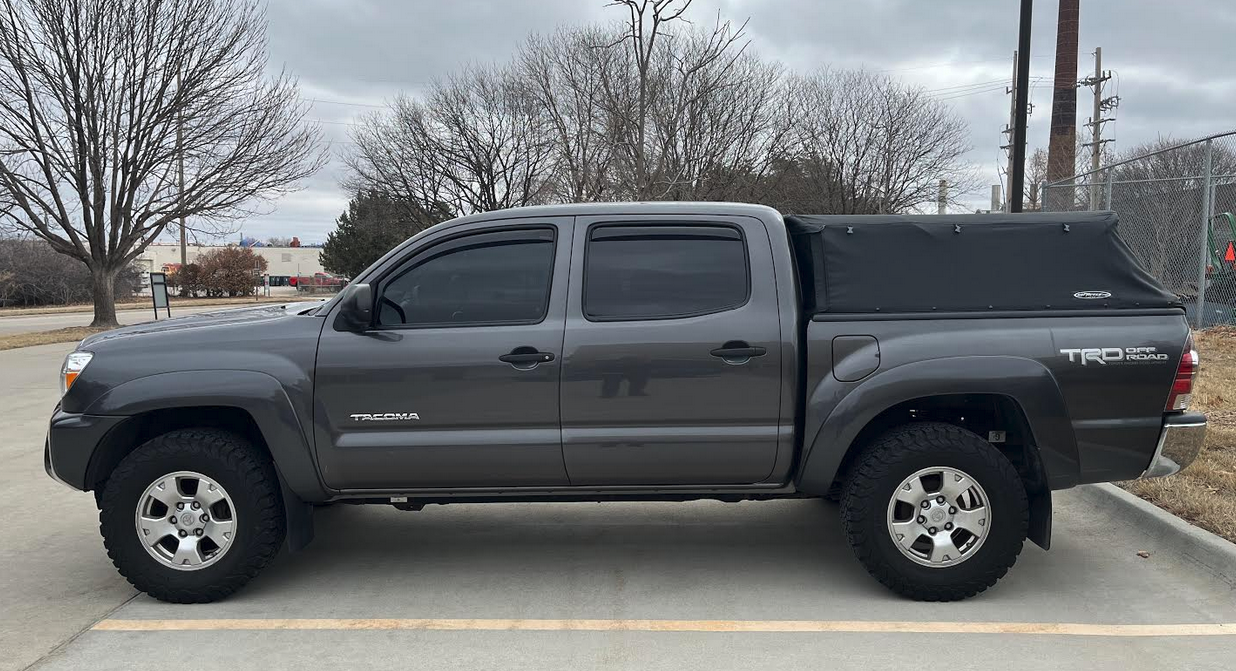

    I just replaced mine yesterday with 4600s all around (truck is stock, first time replacing them) and the front mounts (went with KYBs) and had it aligned today. I bought the truck new, am at 134k miles, so it was time. It's my daily driver, sees dirt roads and mud, but nothing extreme. Just a note, yesterday the truck was almost level, but things are settling and it's almost back to the original rake. I was a little concerned yesterday but happy how it's turned out.

    How does it ride now compared to before?
  16. Mar 7, 2023 at 10:10 AM
    #16
    ma2co
    ma2co Active Member
    Mar 6, 2011
    #52487
    39
    Nebraska
    '13 dcsb trd off road w/tow package
    It's like the tires are glued to the road. And that's a good thing. The minimal bounce that was present is now gone. I was struggling with what shocks to buy, am very happy with my decision.
