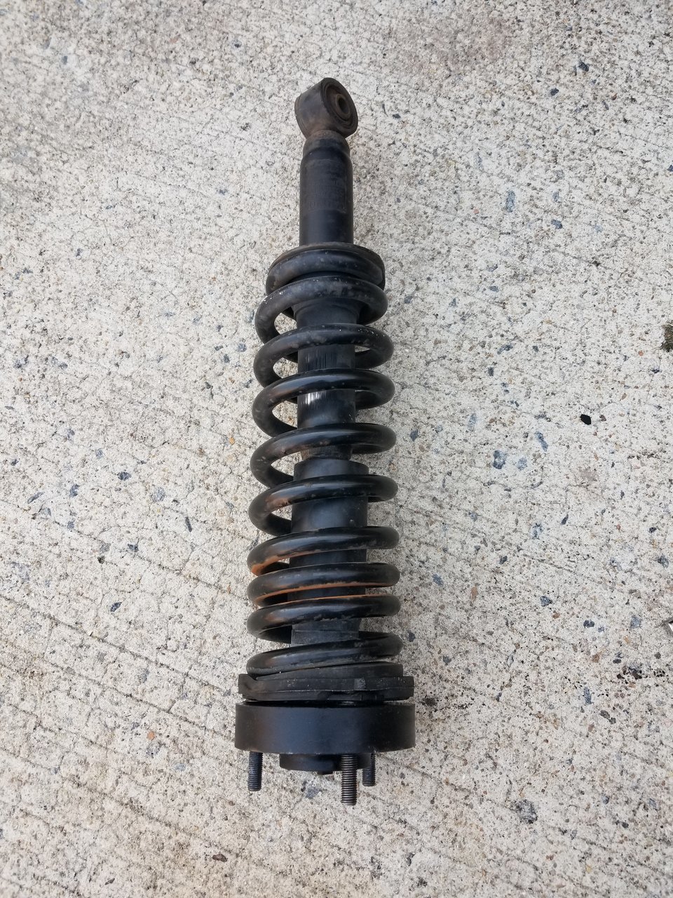

    Hey guys so I have attempted this once before and gave up because I was dealing with stripped/seized bolts and nuts and it just wore me out. But im giving it another go. I purchased the Daystar Comfort Ride 1 inch leveling kit for my 2003 toyota tacoma prerunner. I always hear people say that getting the whole strut out is a nightmare but mine slides in and out no problem. But after I put the spacer on the strut and put the new bolts on top of the old ones and I try to reinstall it, I have no idea how to get to it to line back up with the hole on the lower control arm. Please help guys. The instructions that daystar sent with the spacers was useless and ive lost it anyway, so I dont know what to do. Ive tried pushing up on the upper control arm with a pry bar to try and put it back in but it wont work. Im afraid if i force something to go up or down im gonna break it. 20171130_132638.jpg 20171130_132644.jpg 20171130_132638.jpg 20171130_132644.jpg 20171130_132652.jpg 20171130_132648.jpg 20171130_132656.jpg 20171130_132703.jpg 20171130_132707.jpg

    spud wrench, push the control arm up with a floor jack.

    First if you have not.... remove the castle nut to detach the top part of the spindle from the control upper arm. Then lower control arm will droop more. Then put shock/coil and spacer in. Use floor jack to raise control arm and shock in place.

    OK well as soon as i posted I decided I would just stand on the lower control arm and I actually let me fit it back in so I stuck the bolt in just barely so it will hold it in place. Now I just want to know how am I going to get all this stuff to reconnect since it doesnt line up. Does the floor jack idea work for that. 20171130_134806.jpg 20171130_134812.jpg 20171130_134819.jpg

    You could loosen your LCA bolts (alignment cams) as well. You might have binding at the bushings there that don't allow you move the LCA freely. You'll need an alignment after your install anyway so don't worry about going out of alignment.

    be carefull you dont bitch up the threads on the end of that bolt using it as a pin. A spud wrench to line holes up like this is invaluable.

    I just used the factory bottle jack, and flipped it upside down. put the lifting pad just behind the castle nut, and the base against the flattest part of the inner fender. Gave it a few turns to push the UCA down, and gave myself the perfect amount of clearance to slide my Kings right in, no fuss.

    Breaker bar or long screwdriver under the strut to help align it with the mounting hole.

    Mark alignment cams to the tabs on the frame. Loosen alignment cam bolts. LCA should swing freely now. Attach shock to LCA. Tighten top three shock nuts, leave lower shock nut loose on the bolt. Loosen UCA bolt to frame so that the spindle drops down enough to put the lower four bolts in to place. If sway bar doesn't line up, disconnect from other side, and it will line up. Other side will line up once lift is installed. Torque LCA to spindle bolts to spec. Tighten sway bar end link to sway bar. Snug, but don't torque LCA cam bolts and UCA bolt until truck is on the ground so you don't bind the bushing.

    Just throw that sway bar away. It's clearly preventing all this from completion.
    Stand on that LCA and have someone put the coil assembly in at the same time. Or if you're alone, ratchet strap that SOB over to the other side and pull it down that way. No need to loosen the cam bolts this way.
