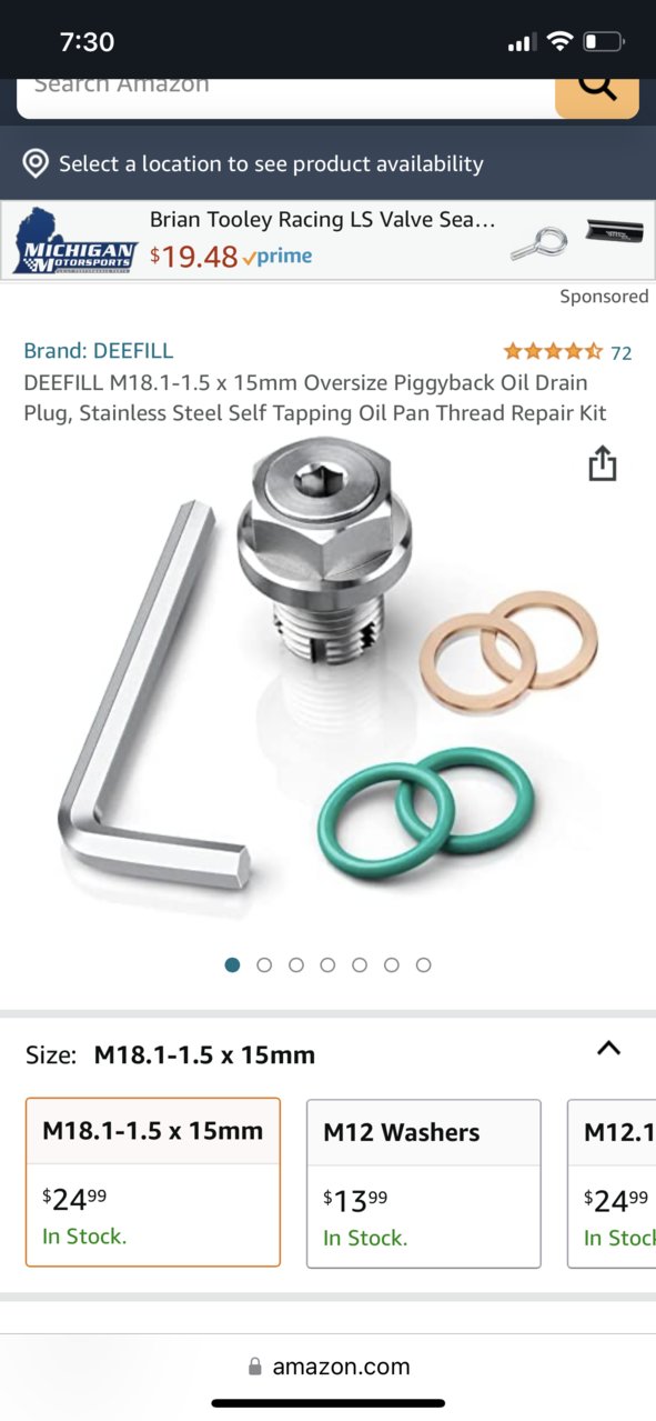

    The problem I’ve run into with self tapping drain plugs is when you take them out sometimes they don’t want to go back in and torque down. I might try something like this. Maybe use some high strength heat resistant loctite. Maybe some red 272. It wouldn’t be permanent that way but should stay in there and you can remove the smaller plug to drain the fluid if you needed to for some reason.
