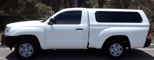

    Really nice! Did you need to remove the black boxes? I really regret not moving up to 31" tires, they fill in the wheel wells. For once I hope my tires wear out quickly. 15,000 miles and they still look new.
