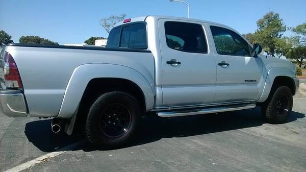

    I want to thank the OP (Gitsum) and everyone else on this thread. Trying to find aftermarket wheels that properly fit a 5 lug is a chore. I ordered the Cragars from Summit Racing and just mounted them. I am happy with the results. Thanks again for the very useful info.
