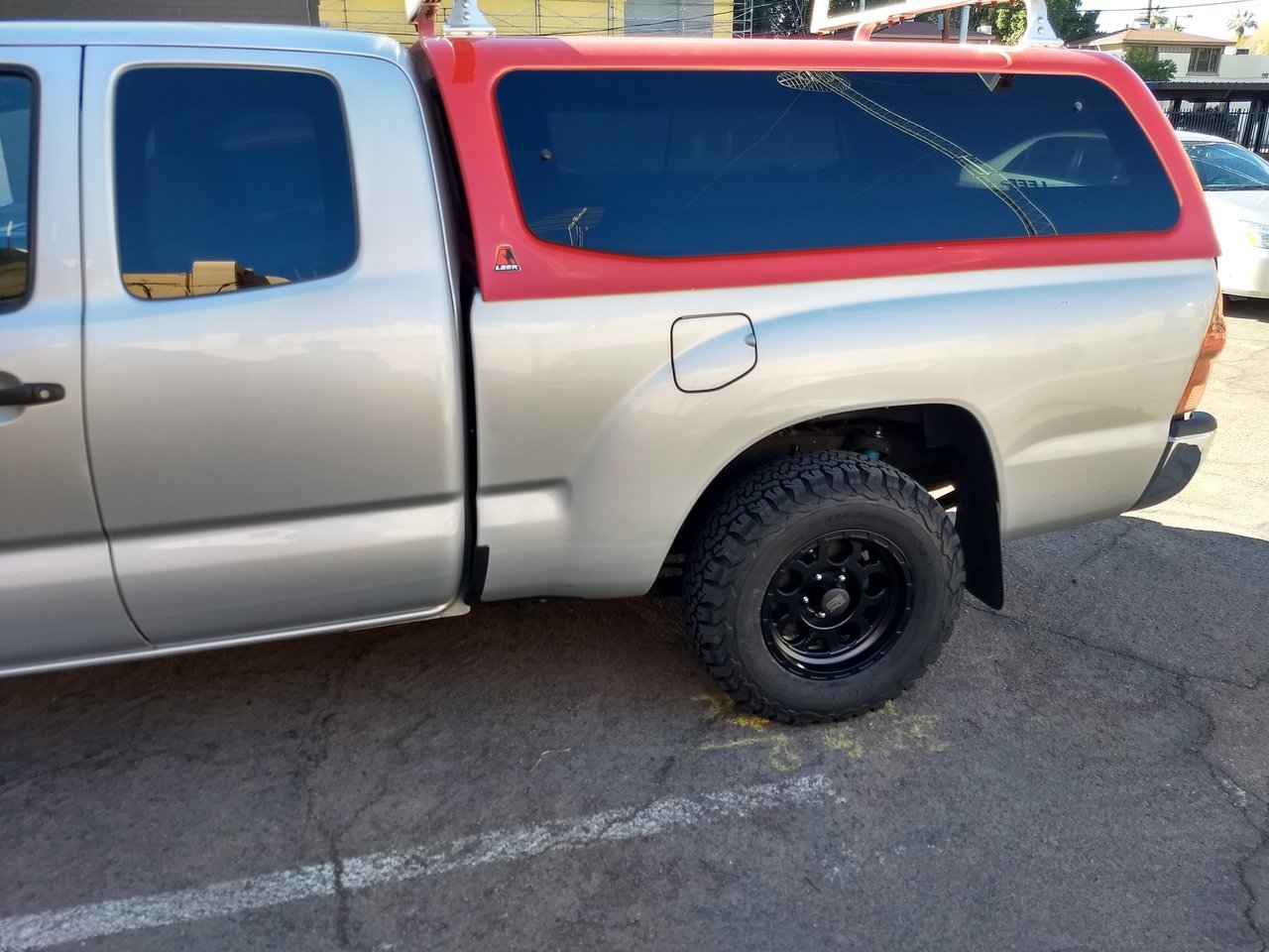

Straight bolt on black rims. "No mods"

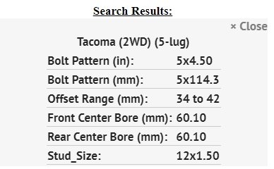

    I found the link to Tacoma factory specs...
    This "chart" is showing the offset for our 2nd Gen. 2.7 2wd as "ET34".
    I've seen various posts saying our factory offset is between 40 and 50.
    Does anyone have the official word on this?
    16mm makes quite a bit of difference when choosing offsets...:evil:

    I've seen it all over the map - from +32 to +45 ..
    I rather suspect that the +34 figure comes into play, when referring to the X-Runner, which uses a 16 or 17" wheel with less positive offset, but shares the same 5-lug pattern hubs.
    http://www.boltpatternfitment.com/toyota-bolt-patterns/

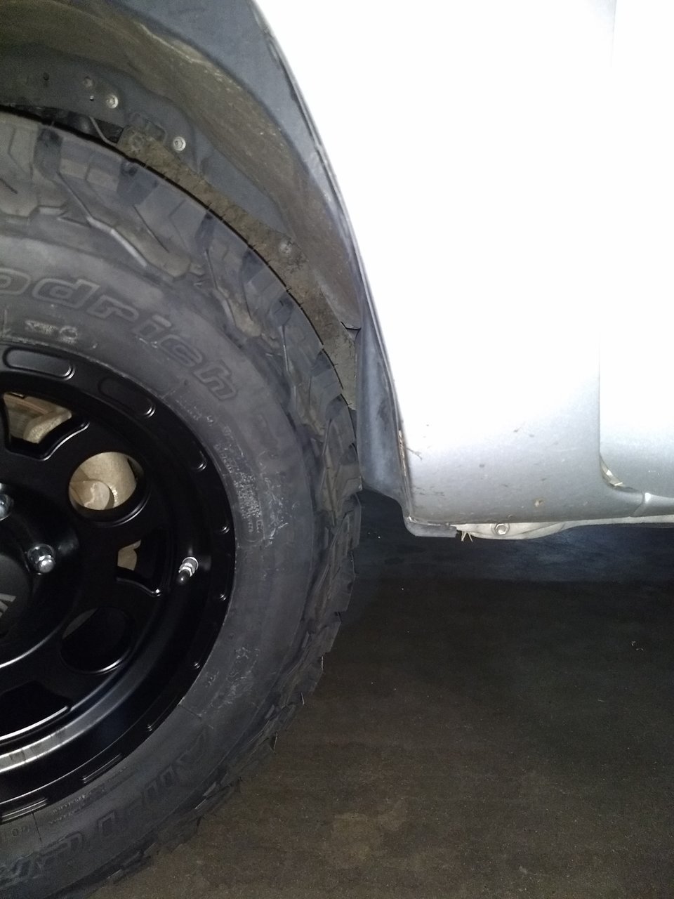

    Another KMX Enduro straight bolt on - no mods needed.
    Slight BB rubbing with the 235/75R15 KO2s...kind of surprised me b/c I thought the 235s would fit w/o BB mod...but no...slight rubbing halfway through a full turn...
