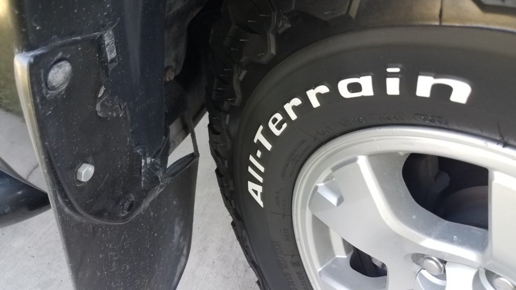

    2021 Silver TuRD Squirt DCSB 4x4 // 2008 Black Rusty Shitbox DCSB PreRunner
    I had 265/75/16 KO2 tires on stock suspension, and it rubbed like a bitch with the front right flap. Trimmed off the corner and it magically stopped rubbing.
    265/75/16 and 265/70/17 have very similar diameters.
