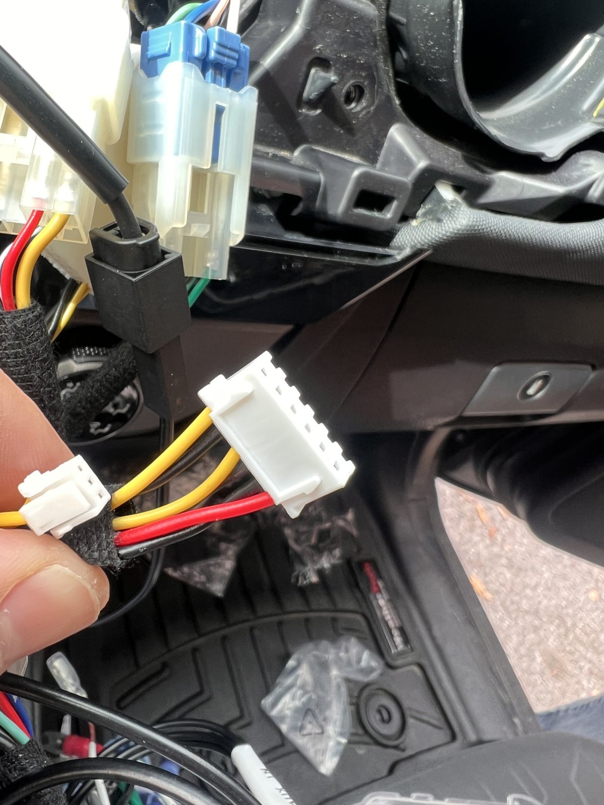

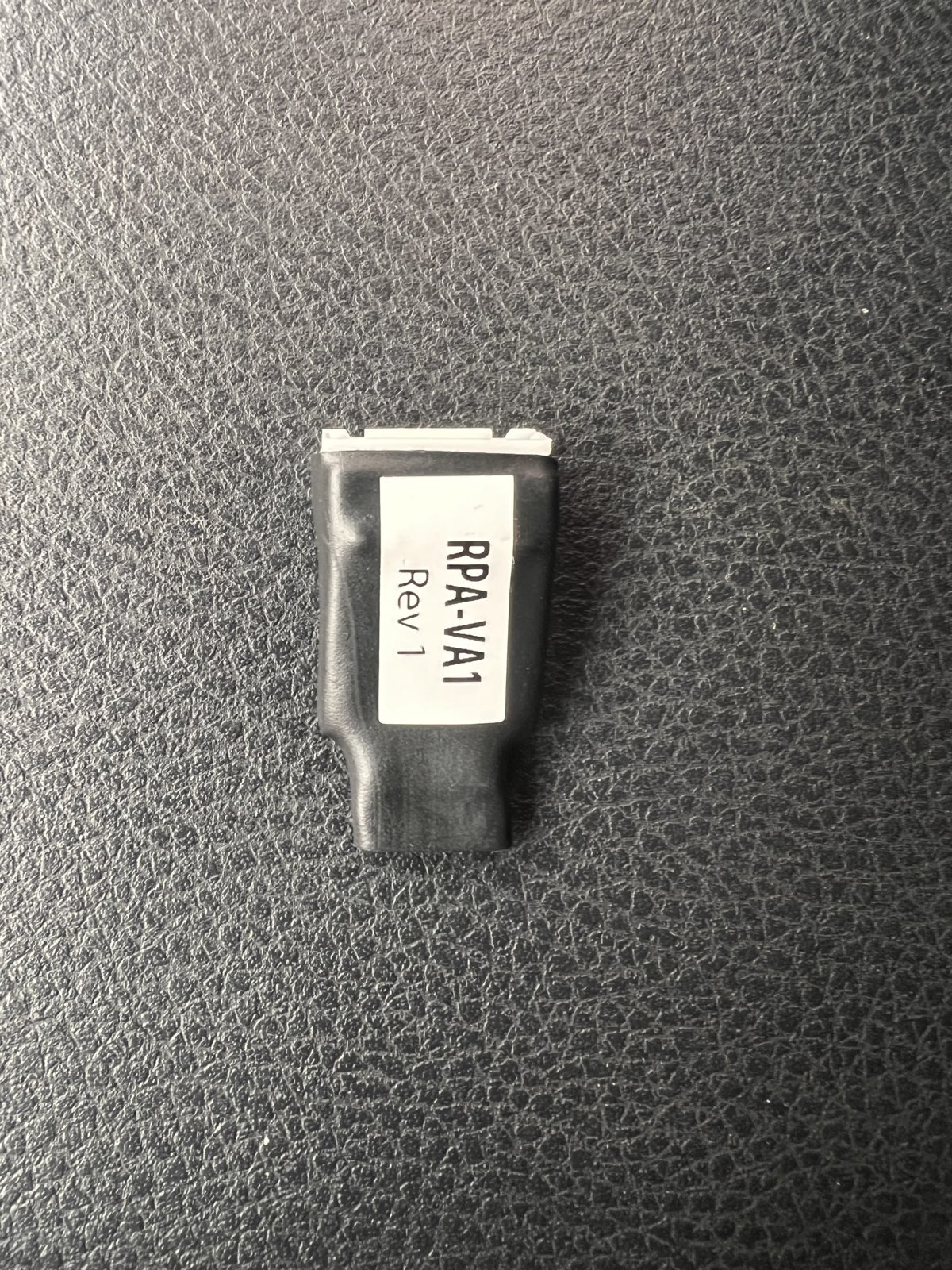

    My issue was that I had a dangling cable on the harness with a missing cap, plugged it in and they started working. Cap and cable pictured below:

    This was my issue too. Instructions are very vague at best, but once I plugged it in.. Bam! Backup cam!! Thank you!!
