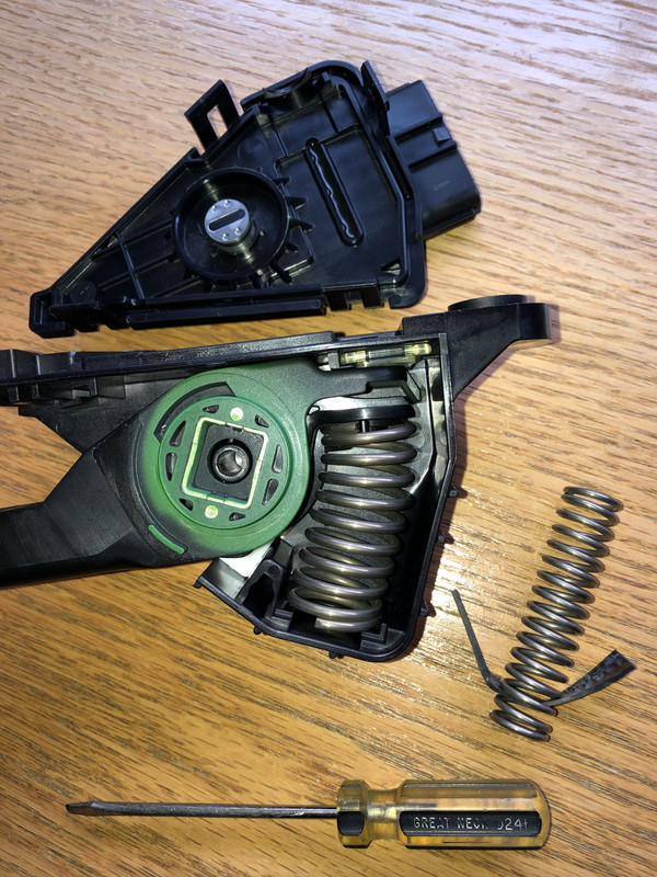

    I just found a simple 10-minute fix for the overly stiff accelerator pedal in my 2020 Tacoma that I figured I'd share in case anyone else here on the forum would find it useful.
    There are two 10 mm nuts holding the pedal to the firewall, and a simple wire connector. I first removed the two nuts, then the the electrical connector. There are four little clips holding the cover on the pedal assembly, carefully pry all four and the cover pops right off. There are two concentric springs that pop out easily. I just removed the inner spring and then put the big spring back, popped cover on, and that was it.
    It is much better now in my opinion. Judging by the design of the two springs, it sure seems like Toyota added the inner spring to add tension. Perhaps it's for safety after that "unintended" acceleration issue they had a decade or so ago. Whatever the reason for the extra spring, I'm really happy with this little fix. Nice thing is that the fix doesn't touch the electrical working of the pedal, and that is was as easy as just removing one of the springs and didn't require substituting a weaker spring for the original.

    Well done. I’ve pondered a similar fix but haven’t gotten around to it. The 3rd gen Tacoma has the stiffest accelerator pedal on any vehicle I’ve ever been in. I’ve disassembled similar DBW accelerator pedals from Subarus before (also made by Denso) and they all have had the two springs in them. Likely as a failsafe.

    Yes, you're probably right, the second spring is probably an extra failsafe. I guess the best fix would be to get two softer springs with the same dimensions instead of just removing the inner spring.

    So I did remove that inner spring of the accelerator pedal assembly. The accelerator pedal feels much more lighter and easier to depress (a good thing, compared to the stiffness before). That larger outer spring is beefy, and is more than enough to return the pedal back to the raised position. I don't see that spring ever failing.
    My accelerator pedal is operating normally.

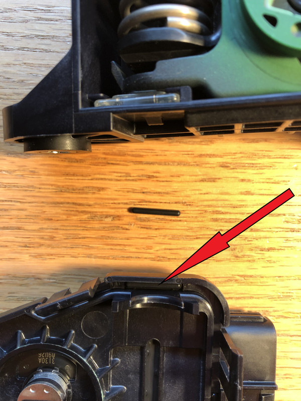

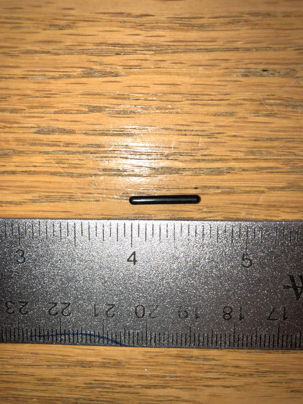

    Now for the million dollar question: When I was carefully opening up the pedal assembly, this fell out. It is a small piece of rubber, cylindrical in design. Approximately 5/8" in length. Where does it go in the pedal assembly? I didn't see any spot or position within the assembly housing for it.

    I didn't see that little rubber piece, but I did see a different rubber piece that was between the two springs acting as a sort of dampener or something.

    It's cool. I'm going to remove it and open it back up again tomorrow, in an effort to discern where that rubber thingy goes. Maybe it's just a cushioned stop somewhere inside the housing, for the accelerator pedal. If I figure it out I'll take a pic and post it here, lest it occurs for someone else.

    So I found out where the little cylindrical rubber thingy goes, in the accelerator pedal assembly. There's a small grove in the cover (see arrow) that it fits in perfectly. Not sure why it is needed there, but it has been reinstalled.
    This is probably the only picture of the internals for the accelerator pedal on the Internet. I scoured the Internet yesterday looking, but no dice. Toyota claims that this is an unserviceable part regarding the internals, so probably why no pic's exist. Until now.

    Good you took some pics for others to see. Maybe that little rubber thing is to prevent the clamshell from vibrating and making noise?
