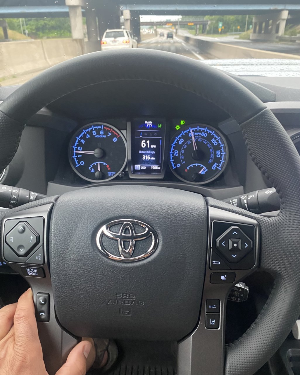

    Is this normal? Was like this since I bought it new. Now 2k on it.
    The vehicle does NOT wander but as you can see from the picture center is achieved when steering wheel slightly tilted to the right.
    If I keep it perfectly centered the vehicle will begin to go left.
    would the fact it’s not wandering rule out an alignment issue?
    See pic

    Mine was like that after my lift - but I had a local shop that I trust do an alignment - and they got it perfect for me. I'm sure the dealership could align it under warranty, but my dealership was like 17 miles away, and this shop is right up the road.

    thanks bud, I was under the assumption that because it didn’t wander an alignment wouldn’t be the cause but I’ll call the dealership and have them take a look at it.

    A toe offset can do this. If that's the cause, a slightly crooked steering wheel is the only issue it would drive straight with no tire wear. If it bugs you, have the dealership look at it,but if that's the only issue, and you are ok with the wheel a bit crooked, you can drive it with no worries.

    Many vehicles are set with a small amount of cross caster on purpose to deal with road crown. Where does the steering wheel want to naturally sit?

    If your truck drives straight and the tires are wearing evenly the alignment is probably good. To center the wheel all you should have to do is adjust the left tie rod in a small amount and the right tie rod out an equal amount to to keep the toe setting the same.

    2 things. Looks like you are driving on road crown biased to the left so the steering wheel would be slightly turned right to stay straight. Since you did say it’s not pulling one side or another then maybe this doesn’t apply.
    Secondly, centering a steering wheel is easily done with tie rod adjustment and is an integral part of a proper alignment.

    It can still be alignment related even if the vehicle drives straight, it's just the relationship of the tie rod positions to the steering rack and pinion. Should be a simple fix, it doesn't appear that you're off by much.
